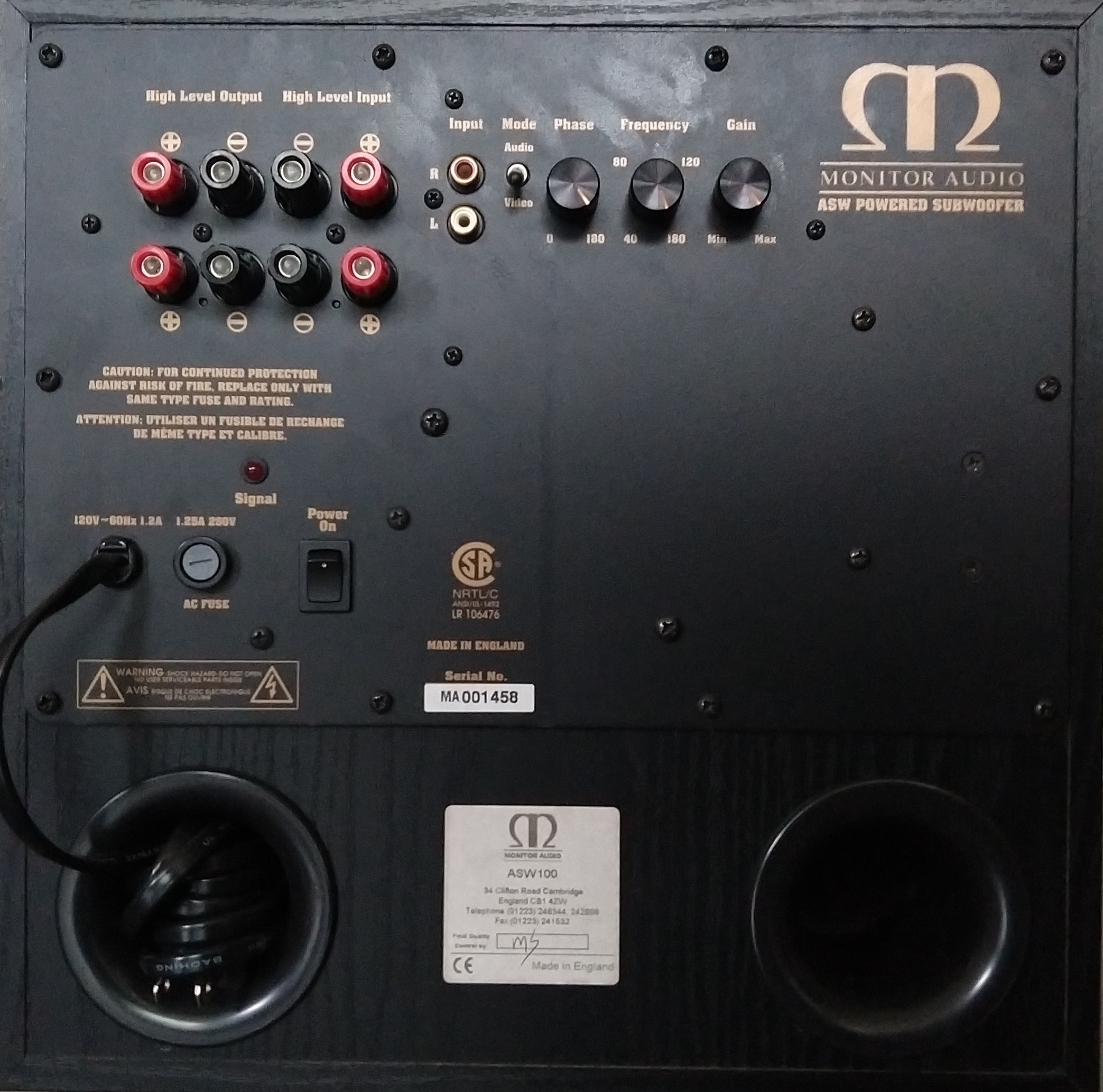

I measured the impedance (resistance) across my monitor speaker terminals using a multimeter. The baby boomers measure 3.6 ohms, the baby center measures 6.5 ohms. The powered sub has 2 pairs of "High Outputs" and 2 pairs of "High Inputs", the inputs measure 1.5 K ohms and the outputs measure somewhere in the order of mega ohms (one output pair constantly increases, while the other decreases).
I bought the onkyo tx-nr656. The big question is - how do I connect all these? Especially the sub. I've attached a picture of my sub for your reference.
I bought the onkyo tx-nr656. The big question is - how do I connect all these? Especially the sub. I've attached a picture of my sub for your reference.View attachment 26865

There speakers are actually already wired (through the wall) and labeled. I was wondering if I have to do anything extra about the lower impedance, because the guy at bestbuy said I don't have to worry if my speakers were 4 to 8 ohms ( mine is less than 4 ohms).
Also, my sub doesn't seem to have a standard plug, it has 2 pairs of High inputs and 2 of High outputs. See here:
Sorry went brain dead there for a second.
I don’t think your receiver will have a problem running the barely lower than 4 ohms load. Onkyo’s are usually built pretty tough. At least the older ones are. Your subwoofer should just connect through the line in (rca) to the subwoofer out on the receiver. Unless I missed something.
Edit: Also don’t worry about the speaker (high level) inputs and outputs on the subwoofer. You won’t be needing to touch those.
The multimeter measured resistance (dc), not impedance. If the d.c. resistance is 3.6 ohms, the nominal impedance will likely be much higher, probably between 4 and 8 ohms. Note that impedance varies with frequency.
Most satellite speakers are not designed to play cinema loud and can't handle a lot of current, so an entry level AVR should be good enough.
