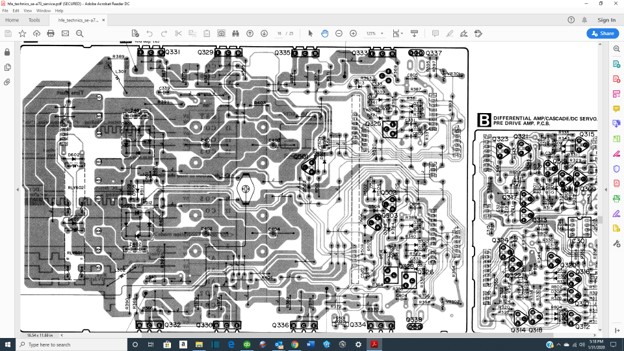

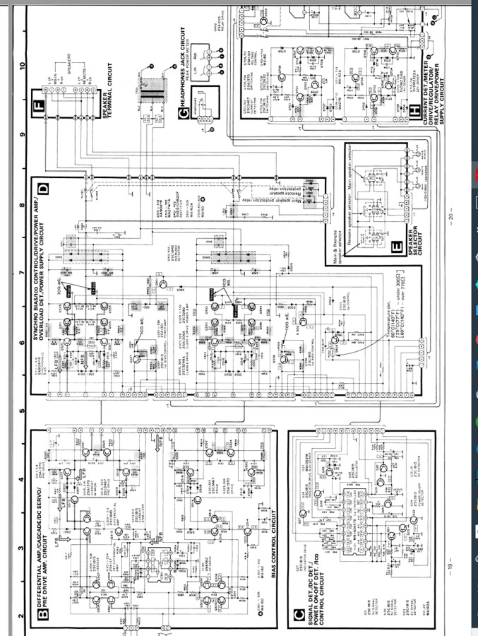

I have down loaded the service manual from Hi-Fi engine. I can not locate the resistor in question. There are just far to many parts and the manual is hard to read.
What I can say is that omitting that mica washer was a terrible mistake and has probably caused widespread damage.
My other observation is that that amp is absurdly complicated and typical of gear of that era from that part of the world. No power amp needs to have that high a part count. That thing is s real thrown together mess. I think it will be an uphill fight to get that sorted out now. I personally would not worry with such a contraption and move on.

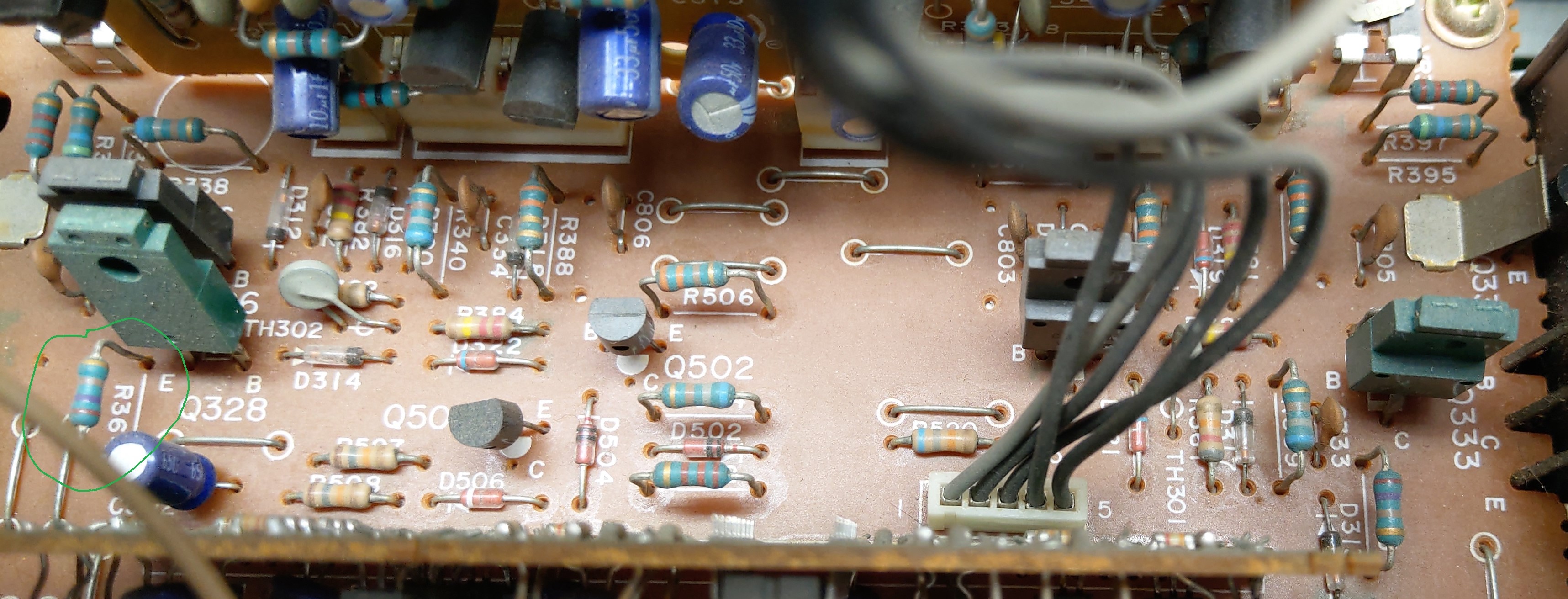

Here's a photo I have circled in green the resistor, if that helps. The pic was taken pre repair/restoration. I bought this new amp new in Germany back in 88. It never had any issue, until the main caps started leaking. My JBL L100T's sound much better with this amp than my Sumo Andromeda which is filling in for it until I get it up an running again. I love the looks of the Technics and I have all the match Technics components to go with it, so I if I have to replace every part on it I will. I just need to figure where to begin. So any help will be greatly appreciated :)
All I can tell for sure is that Q328 is broken down and shorted internally. But that begs the question why. I suspect that its partner Q 326 is probably blown also, in any case they will be a matched pair I'm sure. Whether any of the diodes are bad and the driver transistors I have no idea.
I don't know what test equipment you have available and your level of expertise. You may need professional help here. So I would check the diodes, and then replace Q 326 and 328 with a new matched pair. Restart the amp carefully on a Variac, and watch the voltages carefully with an amplified high impedance volt meter as you cautiously increase voltage. A high impedance amplified meter is an absolute essential. You can do an awful lot of damage with a standard multi meter.
I think you are going to need a signal generator and scope also.
This may well not be easy, as you won't know how far the damage has spread. The other issue is these kind of cases you can keep blowing the same components until you can get a clear idea of the extent of the damage.
When you left out that insulator you will have shorted a collector or emitter to ground depending on whether is was PNP or NPN. That has the potential to cause widespread trouble.
You are not going to rebuild that amp and expect it to work. That is a pipe dream.
If you don't have the test equipment I mentioned, then you need professional help if you ever expect that unit to be functional again. That amp seems to be some type of feed forward design, and those have serious trouble in service as it is hard to make them stable again.
Which transistor did you miss install? It might be helpful to know that.
