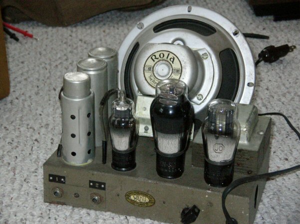

I have a lap steel guitar amp that's over 80 years old- yes, I recapped it but the filter caps were huge, even though they were only rated for 30uF. They're the two Aluminum cylinders are the rear left, near the speaker.
