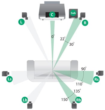

You have to pick a 'main listening position'. It should be close to the speaker arrangement in the following picture, for good surround sound. The Couch is way off to the side to be considered at all. One of the love seat positions will have to be the main listening position. Considering the love seat as main listening position, you can get good equalization for it.
This article will give you more ideas, http://www.audioholics.com/tweaks/speaker-setup-guidelines/home-theater-speaker-layout-an-essential-guide
