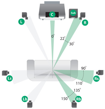

Hi Acoustat. Start with the recommended layout for surrounds (Ls & Rs):
(Click to enlarge.)
Ideally the surrounds should be placed at 90º to the viewing axis, although around to 110º is fine. The distances each side don't need to be the same as the AVR will take care of the required delays and level trims.
Yes, the grandfather clock will need to shift; along with the table lamp from next to your seat. Personally, I'd move the couch out from the wall 12 - 18", but it's not critical. An obvious spot for the right surround is just to the right (as we look at it) of the white door.
Both wall mount and on stands can work well. The choice probably swings more on the types of surrounds available that will give a reasonable timbre match with your Acoustat mains. Is there anything available from Martin Logan, say?

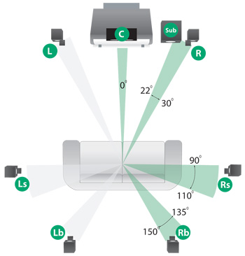

(Click to enlarge.)
