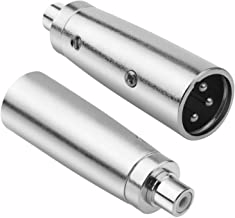

or 2 of these:
The adapter that TLS Guy recommended also works. It has the advantage of raising the signal voltage level, but it will not provide the same noise rejection as a balanced interconnect running between two pieces of fully balanced electronic gear. It also requires twice as many cables or converters.

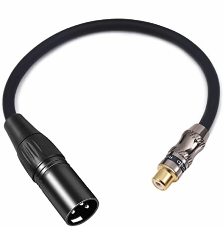

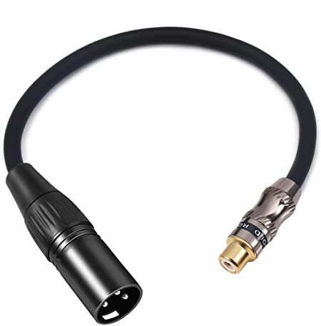

The OP can use the following connection for unbalanced RCA to unbalancd XLR input ( See Figure 4 and connection #17):

View attachment 53561 or 2 of these: View attachment 53562
