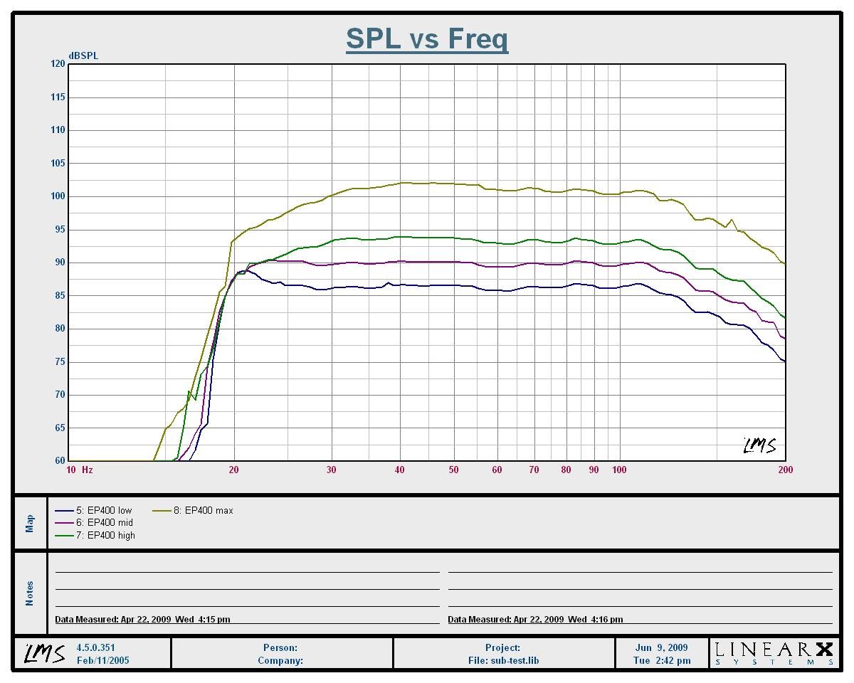

If my memory serves me correctly, Gene was warmly receptive towards it (ep400)...AAMOF...he flat out defended it when people started to dig in their knives...much like the RBH in this review....;). I am not an Axiom apoligist or advocate for Axiom but come on...audioholics.
gene
gene
Audioholics Master Chief
Administrator
If my memory serves me correctly, this sub Gene was warmly receptive towards it...AAMOF...he flat out defended it when people started to dig in their knives...much like the RBH in this review....;).
It's not a bad sub for its size class. I gave mine to my parents and they are quite happy with it. It's just pricey, especially since the $379 Emotiva Ultra 12 outperforms it in some areas. Emo wasn't in the sub business when the EP400 came out so it may be time for Axiom to refresh this sub.
If Axiom would have removed the brickwall filter at 20Hz and used a more gradual roll off, it would have been an even better sub IMO. The EP500 for an extra $150 or so is a much better deal than the EP400, but its also a bigger box.
see my 1 meter GP measurements of the EP400: Axiom EP400 1 meter groundplane Full Screen Image &mdash; Reviews and News from Audioholics
