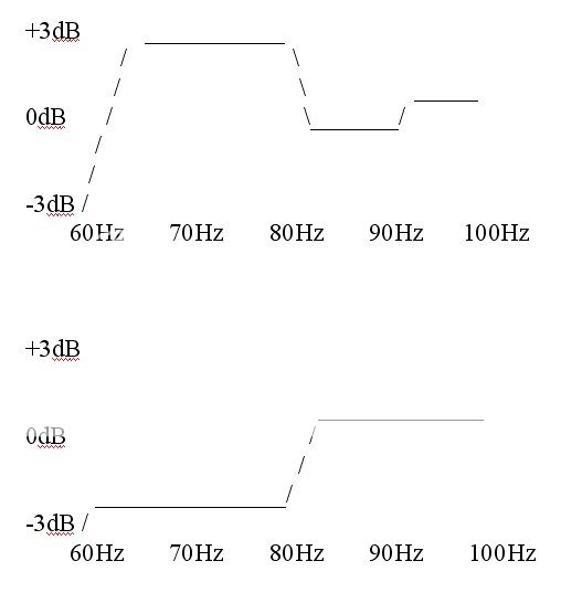

Looking at my Polk Monitor 50s next to my Mirage Omni 150s, one would expect them to have much more powerful bass (since they are much larger.) This impression is borne out by listening.
Now look at the specs: The -3dB point of the Polks is 57Hz, while that of the Mirages is 55Hz. In other words, on paper the Mirages go deeper!
Does this imply that the rated frequency response is comletely useless?:confused:
To confuse matters even further, my KRK ST6s are in-between the Polks and Mirages size-wise (though closer to the Mirages), rated to 60Hz, and have more powerful bass output than either one!:eek:
Quoted frequency response is not of fine enough resolution to discern how the bass will sound.
For example, the two illustrations below are of two hypothetical speakers that have a -3dB point of 60Hz:
As can be seen by the "measured frequency response line", although both speakers have a -3dB point of 60Hz, the actual output above 60Hz is very different, and very audible.
Also, printed loudspeakers frequency response is given relative to the input; so a frequency response of 60Hz to 20kHz +/- 3dB means that between 60Hz and 20kHz the speaker will deviate no more than 3dB from the input signal (at least, that's what I've heard... ;)).
Edit: I apologies for the hideousness of the illustration, but the it seems I cannot use spaces to draw a picture, and my scanner isn't working so I couldn't draw one by hand, and... you get the idea. :eek:
It gets the idea across well enough. The FR graphs I have seen resemble your first example far more than the second. (I wish such graphs were available for a much broader range of speakers, though, as they are far more informative than specs alone.)
