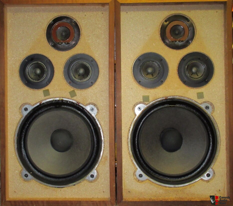

Hello to all, i am new here and i am looking for information on the Nova 8 speakers. I purchased a pair from a yard sale. All the speakers are original and the foams like to be in perfect condition. The speaker boxes are in excellent condition, all four corners are intact.
Hooked them up and they sound great!!! Except i don't hear the tweeters in either speaker. Are the tweeters blown? How can I test it? Also is there anywhere i can purchase or replace them other tweeters?

The cost of replacing the tweeters are more than the speakers are worth. You can find some on ebay by looking up the search term "radio shack realistic nova tweeters". There are various prices for various quantities. I wouldn't bother though. Just toss them and look for better speakers.

I looked at the Nova 8 pictures. The tweeters are the old CTS phenolic dome tweeters. There is no dome about them though. They were cheap cone type tweeters which back in the 70s cost $1.50 each! They were widely used. They are actually still available for vintage restoration.
You can get them from Parts Express for $18.50 each.
That is definitely the one. Be careful on eBay as sellers are too stupid the tell the midrange from the tweeter. One word of caution those tweeters did burn out easily unless crossed over high. So a lot burnt out. So be careful how loud you play the speakers after repair. Those were a very low end "cheap and cheerful" unit.

Those were called 'Phenolic ring', not dome. They weren't able to handle much of, well, anything- clean or distorted. They did last longer if the crossover slope was steep and/or the F3 was higher. So many had a 3.3uF cap flying in the breeze inside the cabinet and nothing on the woofer- if the speaker had a mid, it was usually fed through a cap in the 10uF area.

The bottom line is that they are very nasty cheap cone tweeters, no matter what terms are used to gussie them up.

No term is going to gussie those up. Still better than the piezoelectric ones with a plastic horn that were called 'Super tweeter'- those were brutal.
