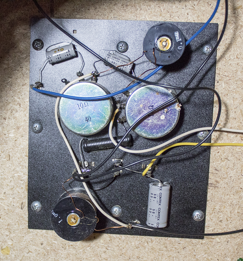

I have a pair of Nova 7's and i to recap the crossover put i hve no idea of a starting point, can someone point me in the right directions, IE: where and what parts to buy, is it worth it?

You need to know the values of the caps you are replacing. Can you read the values on the old caps? If not, you will need to get a schematic somewhere, and good luck with that. Those speakers aren't worth the effort.

thanks for that response, i will take it into consideration, i have not pulled the crossover to look at it yet, i guess that would be the first step.
If i pull one crossover and the values of the caps, should i assume that the other speaker has the same value?
Why would you replace caps when you haven't even inspected the old ones?
Other than obvious physical failure (like an exploded/leaking cap) you could test them....but if they sound great why mess with them?

is there anyway to tell if it needs recaps?
Why not have some fun and replace them, with some poly caps .... change one speaker and test it against the old one ... see if there is a difference to you ... but since you changed one speaker then change the other one .... use the same value for each cap you replace .... if 3.3 then use a new 3.3 ... check the others for their values --- have fun

Your photo doesn't show any obvious signs of cap failure, like a bulging or leaking cap. There are two things you can do to tell if crossover caps should be replaced.
  • Measure the frequency response of those speakers. If you had a speaker measurement rig, you probably wouldn't have asked your question. Moving on…
  • Measure each individual cap with an LC (inductance/capacitance) meter. LC meters are quite a bit less expensive than what you'd need for the first item. (Search Amazon for 'LC meter') To measure a capacitor properly you must cut it's leads and remove it from the crossover. If its capacitance is within 10% of its printed value, its still good. If not, replace it with a new cap that is within 10% of the original cap. In reality, once you cut the leads to measure the cap, you might as well replace it with a new one.
  • Replace them with inexpensive metalized polypropylene caps, such as the Dayton house brand from Parts Express. There is a myth that says different brands of caps, or caps made with different materials, in a speaker's crossover make for different sounds in speakers. On some other audio forums that myth gets great play. Don't get caught up in that. It's no more true than the myth that different speaker wires generate different sounds of a speaker. People may believe such myths, but there is no evidence to support it.
