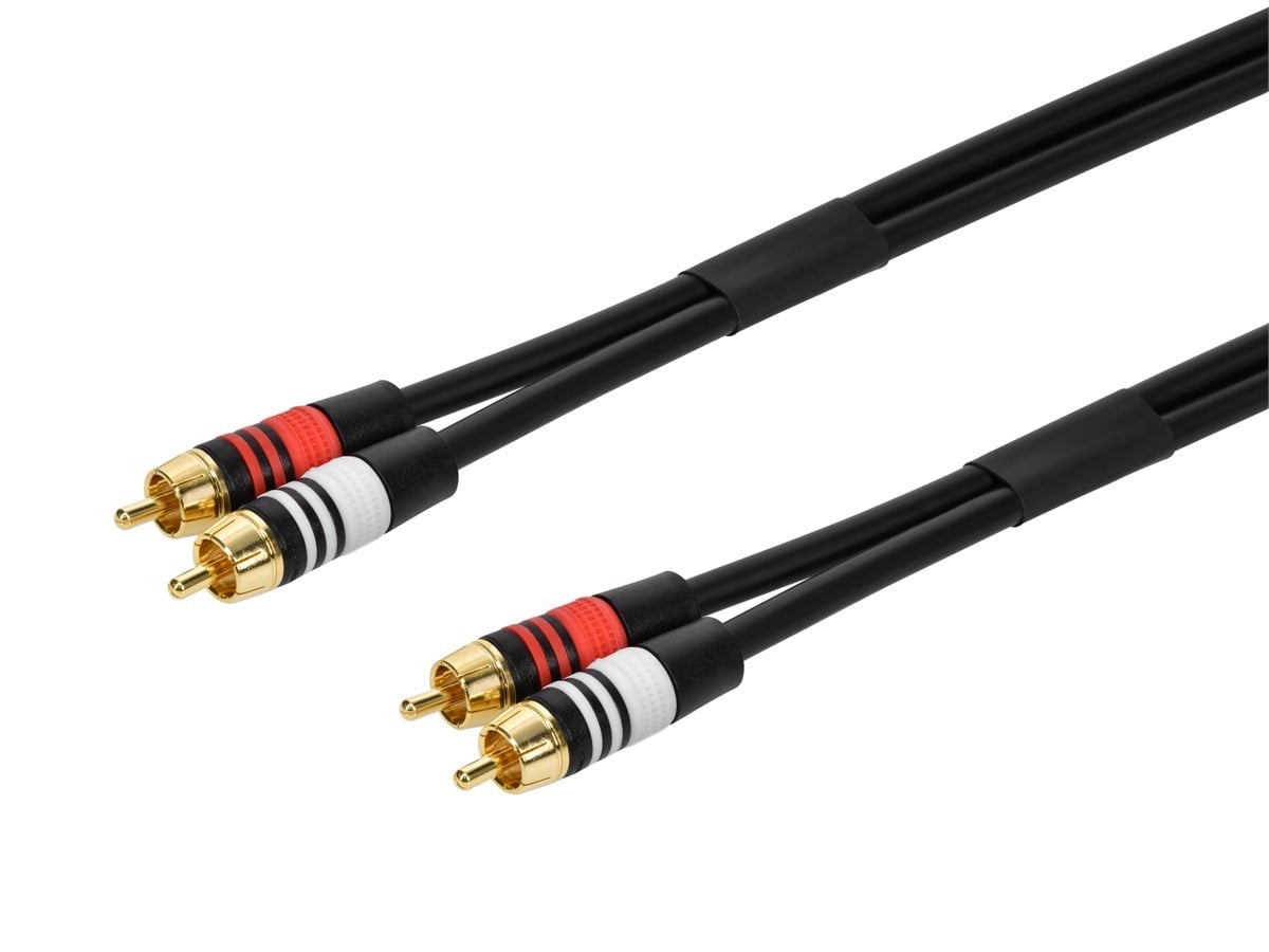

heres the type of av cable im talking about(i call it an AV extention cord, thats what i use it for anyway) http://www.antonline.com/p_AV20301-06-NX_269461.htm .
That's not what I was expecting. Not that it won't work, but it's not what I expected based on the other cables/splitters that you mentioned.
Would you mind also putting up links/images of the other cables/splitters that you are using? It might be something in how you have them put together.
Thanks.

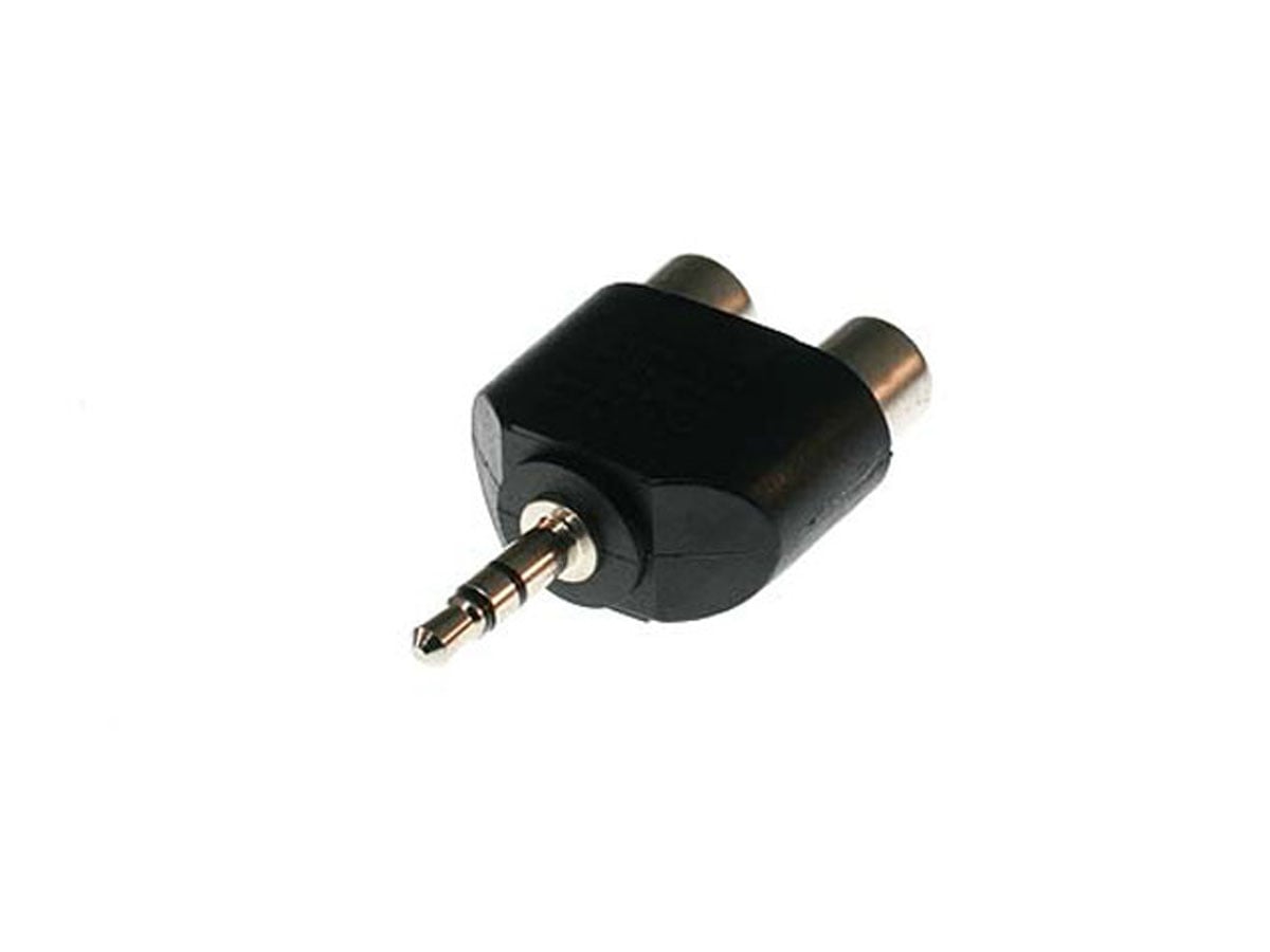

1. the first thing is something like a Y-splitter. but its output is for AV Cables.
2.plugged into that is this but it doesnt have a video cord on it, only 2 audio cords.
3. i have a cord thats like a Y splitter, accept its a cable. My AV Cable(#2 above) is plugged into that, and this cord goes into my AUX port on my speakers

Perhaps these details aren't that important, but when troubleshooting, I like to know that I have the full picture. So, are the connectors on your cables/splitters like the ones shown below (ignore the length of the cables...just focus on the connectors)?
1. Plugged into the TV headphone jack:
2. Plugged into the cable/splitter from #1:
3. Plugged into the cable from #2: The one that you linked from antonline
4. Plugged into the cable from #3:
Phil Taylor
Phil Taylor
when i tapped on the earpiece their was a low tapping noise, kinda like when u tap on a microphone
That's exactly what you should have heard. You say the "splitter" plugged into your TV is for A/V ... and that the cable you're using does not have a video cable ... so I'm wondering if your splitter is of the "tip, ring, ring, sleeve" type - like is it a breakout cable for a DVD player or some similar device with one video and two audio outputs? If so it's probably not contacting the proper points in your TV's headphone jack which would result in improper audio signals output to your speaker system. The proper headphone type audio Y will have a mini plug with "tip, ring, sleeve" connector.
