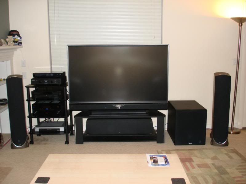

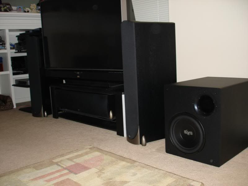

Ok downloading some pics and doing the mic setup on my Elite as we speak. I got all the cords to reach with no problem and I even think it sounds better with fronts spread out. I just have to get use to the way it looks ....pics to follow . Thanks Adam for your help "again" :cool: Oh and our cords on our SVS subs are 10 gauge ;)
