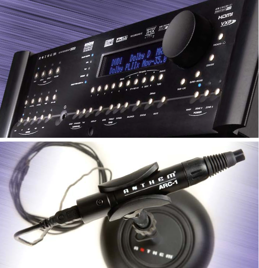

Anthem did offer a little bit of explanations:
"Nick Platsis: It is reliable up to 5 kHz. After that it starts becoming too directional with increasing frequency. Maximum correction range for MRX receivers is 5 kHz. This is the normally recommended setting, and the default, in all versions of ARC and is user adjustable down to 200 Hz. In AVM/D it can be set as high as 20 kHz, but effectiveness of correction at these upper frequencies often depends on whether the tweeters (and mic) are at ear level. A listening test is the best way to find out."
