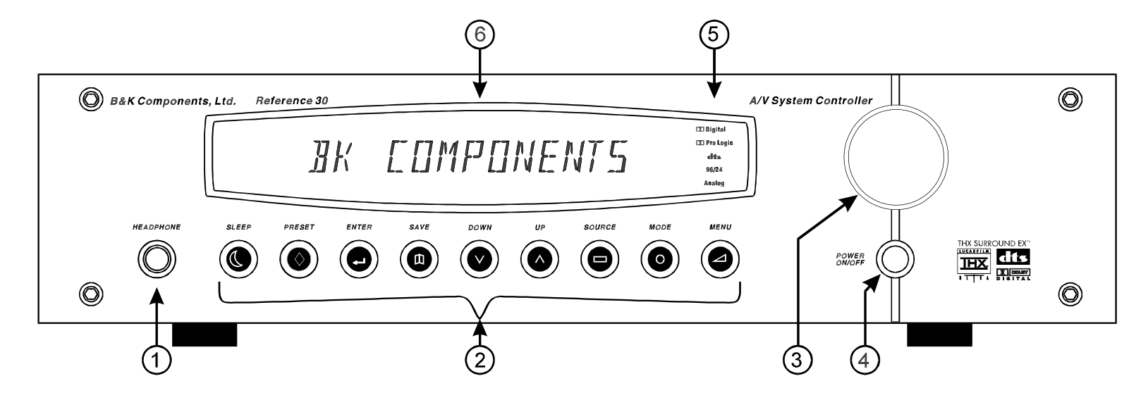

Problem: Ref 30 receives surround bitstream but only decodes to analog ProLogic. No digital surround processing
1. When DTV HR-44 audio set to PCM, Ref 30 shows ProLogic regardless of surround format it is receiving
2 When DTV HR-44 set to Dolby Audio, Ref 30 changes from ProLogic to DD ** but will auto revert back to ProLogic if pgm paused, reversed, etc. When play is resumed, no sound **
Desirable: Mode 1: I am assuming Ref 30 receives PCM bitstream and could decode surround to appropriate analog or digital formats
Less desirable: Mode 2: DVR Dolby Audio turned on - I assume then the DVR is providing the specific surround format. - i.e. Ref 30 routes what it sees
I'm an amateur audio enthusiast. Have had Ref 30 over 20 years, know the menus well. Core to the design is auto-detect surround bitstreams and route as per setup. Auto-detect is integral to the design and, unless you have very specific apps, cannot be changed - yet...not happening.
Separate digital audio input, similar issue with Roku except it never sees more than ProLogic - ever
??? Has the digital side of my trusty Ref 30 gone out?
??? Any explanation for revert from DD Surround back to ProLogic when pgm is paused (or channel changed etc) and the DVR has detected and is providing the correct Surround format? (and not the Ref 30)
I'm at a loss....any ideas are very much appreciated - THANK YOU

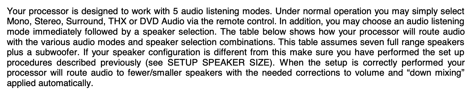

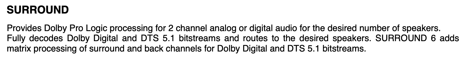

If the DTV HR-44 is set to output PCM, it will output a two channel signal in PCM regardless of the actual audio track in play. The Ref 30 will use Pro Logic when selecting Surround mode to expand audio into additional speakers when playing two channel analog or digital PCM signals. If the DTV HR-44 is set to Dolby Audio, DD will be displayed as the incoming signal. The signals can be DD 2.0, DD 5.1 or even DD EX.

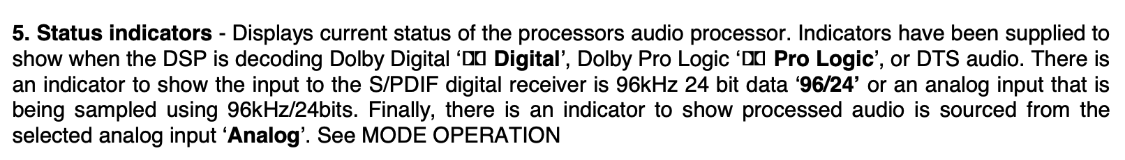

Whenever Pro Logic is displayed, it is referencing the current mode in use, not the signal. If it is displayed, you know it is working with a two channel signal or no signal at all. So, if pausing a Dolby Digital 5.1 signal and using Auto Surround mode, the display may go from Dolby Digital to Pro Logic.
The Roku may be set to PCM output as well rather than bitstream of audio track. The model of the Roku would be helpful here.

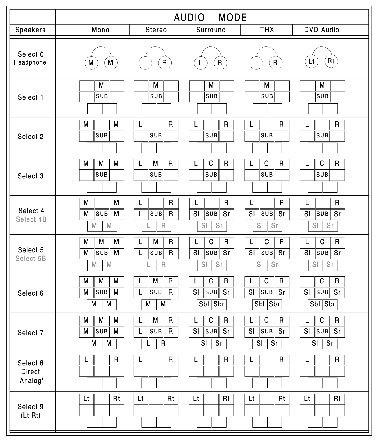

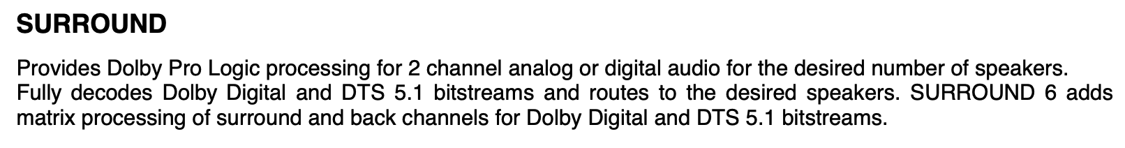

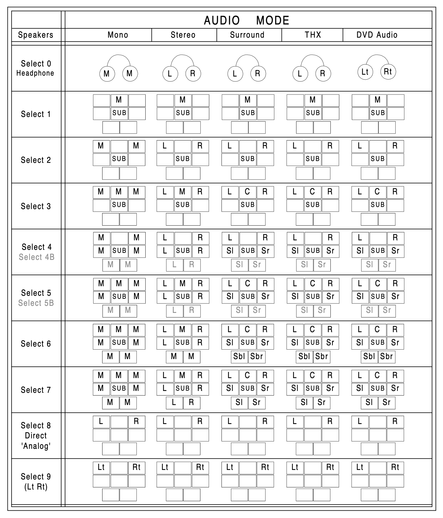

If you are using a 5.1 setup, you need to use Surround 5 at minimum. If you have a 7.1 setup, you need to use Surround 6.
