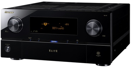

If we're going to spend that kind of money why not get a Pioneer Elite SC series receiver?
Both the Pioneer SC-35 and Rotel RMB-1565 use the same ICEpower Class D technology. The power cabibilities are going to be neck and neck between that receiver and the Rotel amplifier.
The cost of getting both the amplifier and the Pioneer Elite VSX-32 exceeds $3000, and the SC-35 is going to cost half of that, have more features, and take up less space, all while having combarable amplifier performance.
I'd wager the SC-35 would outperform the soon to come Yamaha RX-A2000. The RX-A2000 seems to be built on a platform that's used for the RX-A1000, RX-A2000, and RX-A3000 receivers, and are very similar aside from small increases in weight indicating a larger power supply. Because the Yamaha receivers are a Class A/B design and the Pioneer Elite SC-35 is Class D it is difficult to determine how they would compare without testing each one, but the Pioneer is around 40 pounds vs. the Yamaha's 35. Class D designs are typically lighter for the same output power leading me to believe it's likely the Pioneer will edge out the Yamaha in overall output. This is not concrete, but it's a good indication.
Did I mention the SC-35 is one sexy looking receiver?

That is quite sexy indeed! :)
