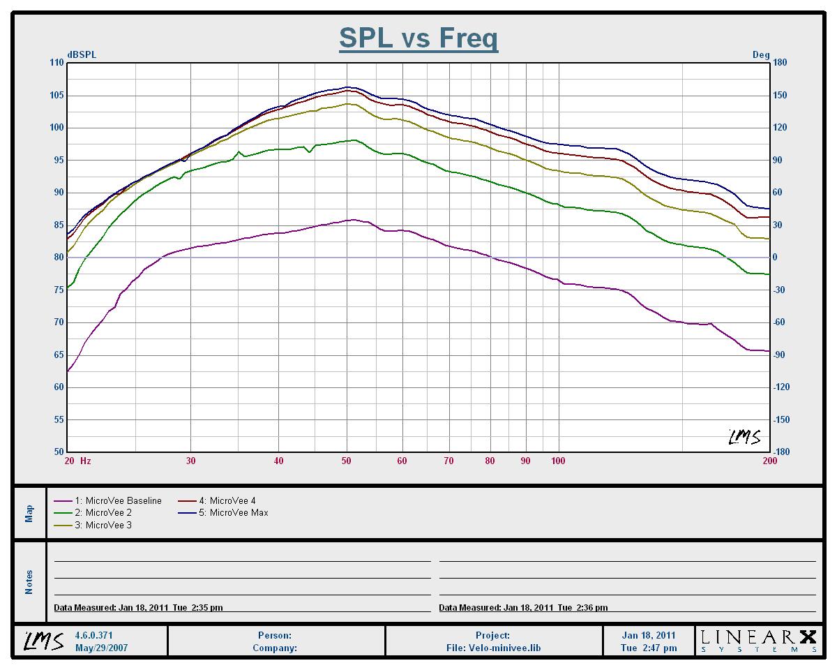

I'm pretty impressed by the Minivee 10's specs (23hz, 1000rms), and go figure, it's the sub that I told them to disconnect when I was doing a demo for the Imagine Bs. I was shocked at the noise coming out of the tiny cabinet before they did. As I said, I found one for $500, and will be able to go pick it up..hooray!
those specs forget to mention two things
1)23hz at what SPL? 80db? As soon as the output rises, the sub will scale back output at lower frequencies.
2)is 1000 watts a sign that the sub has a lot of output, or that it isn't very efficient and needs power just to perform at average levels?

1. I'm unable to find that spec for the 10. What can you help me read out of this for the 8?
http://www.audioholics.com/reviews/speakers/subwoofers/velodyne-minivee/MiniVeeSPLVsFreq.JPG/image_view_fullscreen
