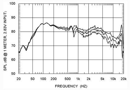

Perhaps luckily for you, the Two B was measured at the most famous facility of all, the NRC. Hopefully a couple of experts can chime in if they get around to checking out the graphs.
http://www.soundstagenetwork.com/measurements/speakers/psb_synchrony_twob/
http://www.soundstageav.com/onhifi/20080201.htm
Top curve: on-axis response
Middle curve: 15 degrees off-axis response
Bottom curve: 30 degrees off-axis response
Top curve: 45 degrees off-axis response
Middle curve: 60 degrees off-axis response
Bottom curve: 75 degrees off-axis response

As for the graphs, I really wish I remember better what a bump at "xxxx" hertz is supposed to sound like. Depending on where the bump is, it may sound forward, or chesty, or something else perhaps. The two spots where it looks like it is least linear to me are somewhere between 800-900hz, and 4000-5000hz. I wonder what that is "supposed" to sound like.
I'm sure everybody exaggerates the specs, but the NRC test put the sensitivity at a low 84 db m/2.83v. That along with its 4 ohm rating might mean that you're going to want more than average power.
