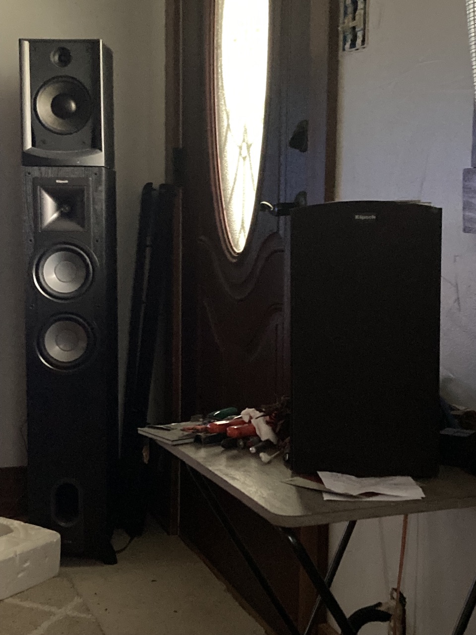

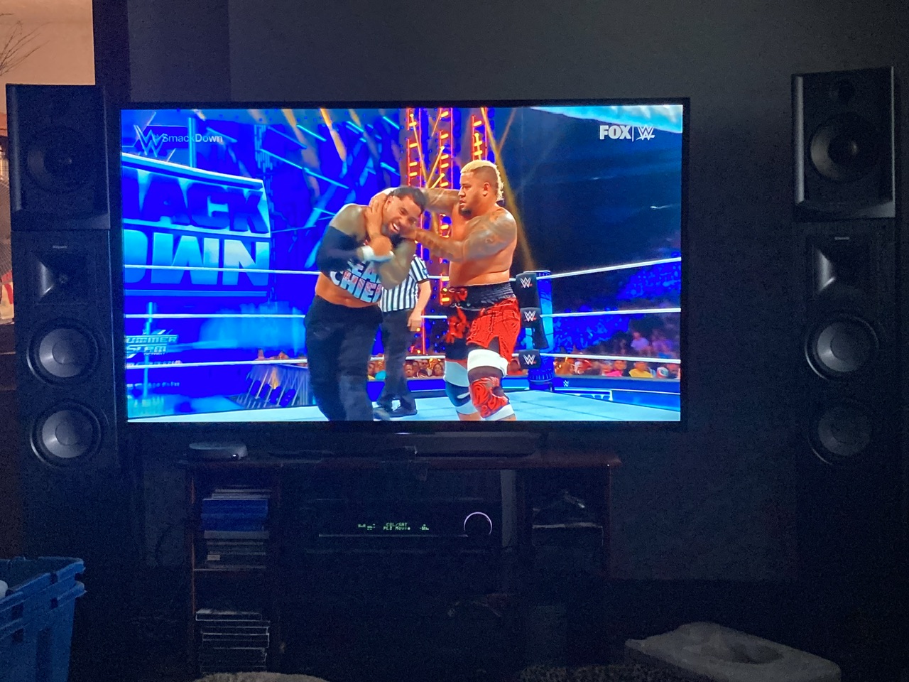

Well sitting on top of the tower won’t do much. They should be like three feet above the mains for plIIz. Even then, the heights only play back material that’s extrapolated from the mains. So really what you get is a taller soundstage. Seems better for music than movies but ymmv. If you can’t mount them higher, I would skip them.

Did you move them up to about 3’? You won’t likely notice them at all sitting on top of the mains since the only sounds they produce come from the LR main channels. It’s not like they receive special effects made for those speakers like Atmos.

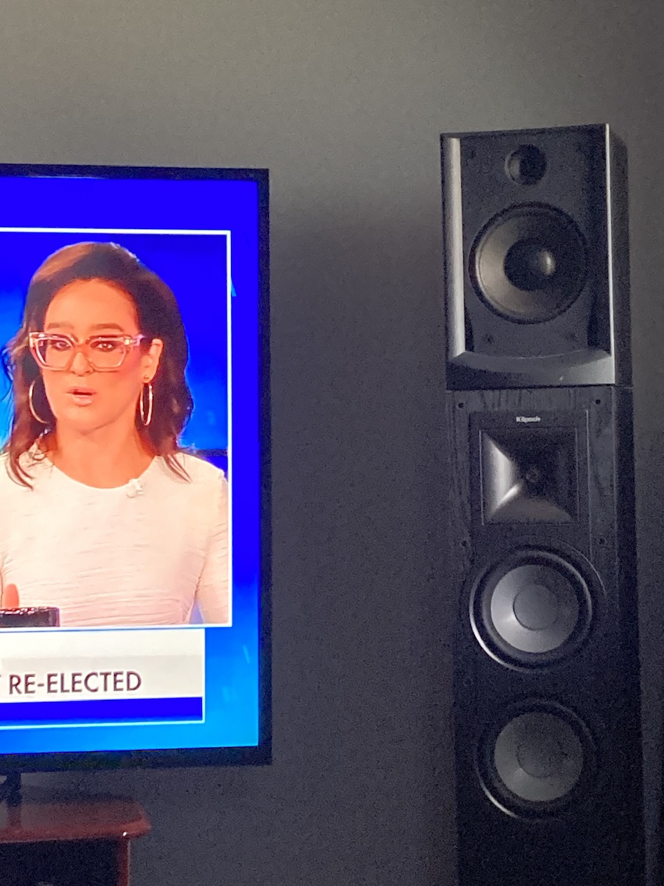

I would point the heights straight out compared to the mains. With them on the same axis, you might not be benefitting from the sound they produce. Heights should be higher than that ideally too, like 1-2 ft. higher.
Is the toe in of the mains fine I’m running phantom ?? As for Heights I don’t think raising them would do much for this room because it’s a open floor with two door sized wholes

The toe is fine. Raising them is exactly what you need to do. Room is fine, and they’ll work. As long as you raise them. Do the have keyhole slots? If not, go to Home Depot and spend five bucks on some keyhole mounts and screw them into the speaker. Hang them up, and test them out. It’s cheap and easy. If you don’t want to mount them up, then quit using them. Easy.

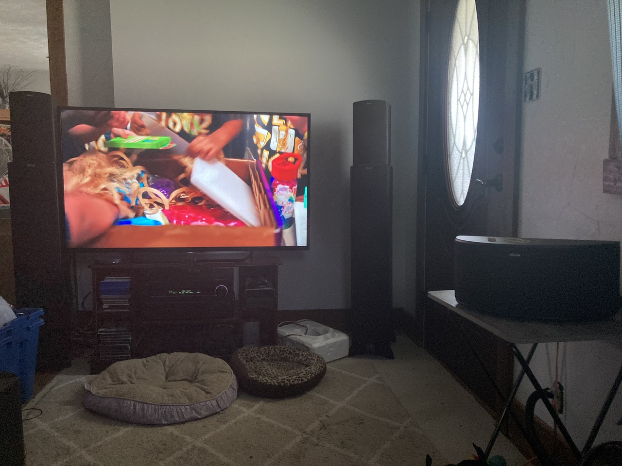

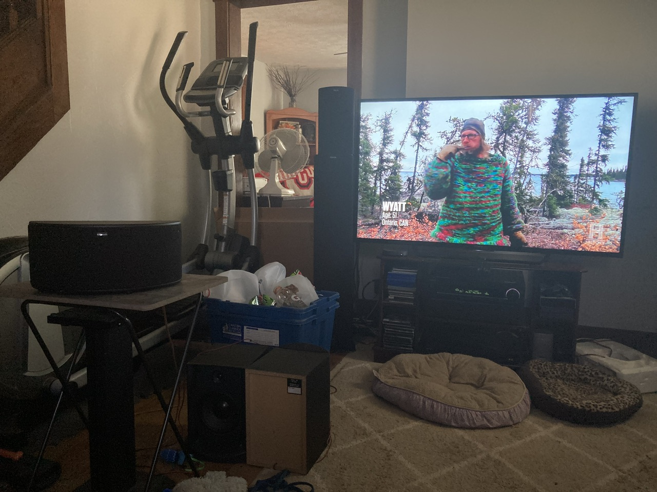

And move the surrounds to the side. Take the energy you’re NOT applying to a job, and at least set your shitt up right. Don’t tell me your mom said…

They put this big couch in this room I can’t set surrounds in proper position without putting a shelf up behind the couch and my ocd mom won’t let me do that. Infact I have a perfect shelf that would work I paid for it’s sitting in the garage unused ..
if I want proper surround I’ll go up in my bedroom and watch that . The sub walks all over my Klipsch set ups jamo sub. Both sound good though imo but a 10” vs a 15” is a no-brainer .
