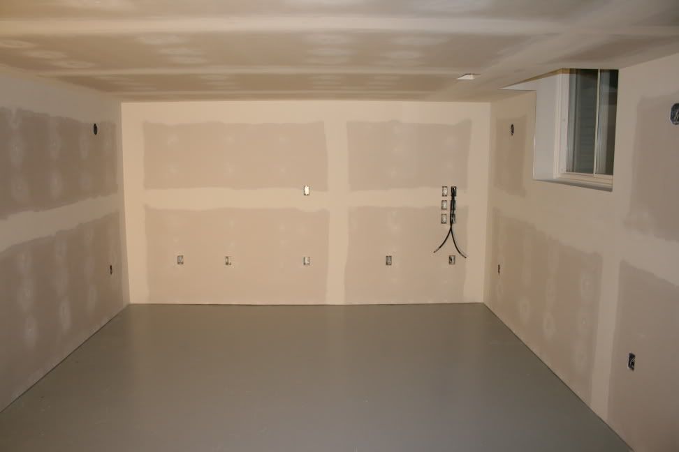

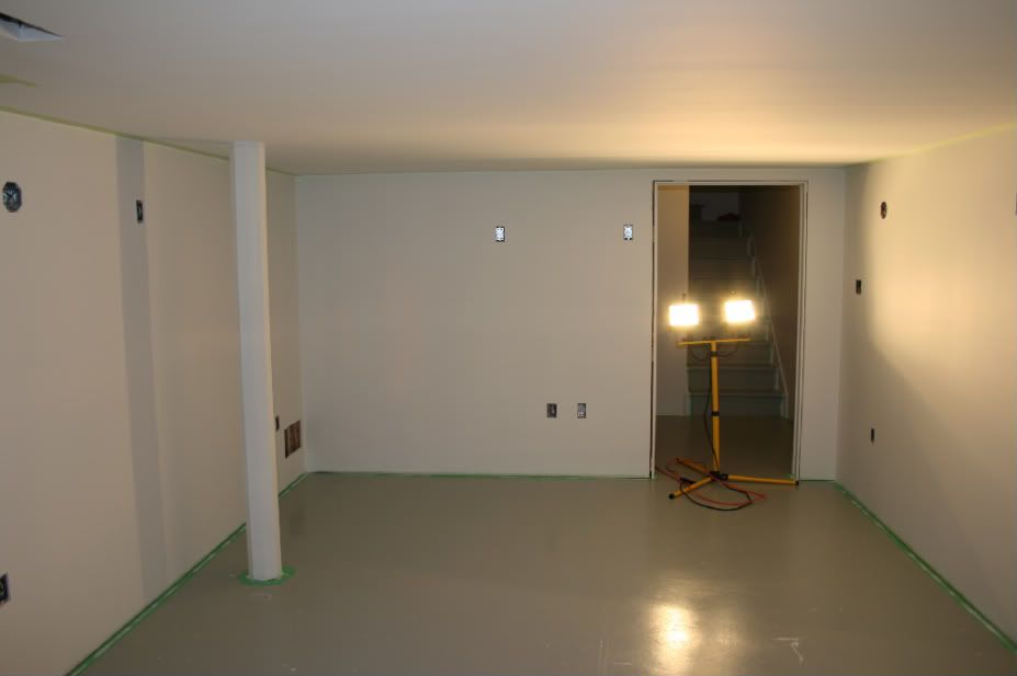

The projector could be mounted on a shelf on the back wall in between the two rear centers... say roughly about 6 feet off the ground?
My concern is that the bottom of the projected image may be impeded by the couch and or the people’s heads that are sitting on the couch. Another concern I have is that if the projector is shooting the top part of the image straight out to the top part of the screen, does the bottom part of the projected image get distorted or stretched at all because the projector would have to be angled downward a fair bit to hit the bottom of the screen.

By the way, here is the front wall, that the screen would go on:
And here is the back wall, where the projector would be mounted in between the two electrical boxes higher up on the wall:

I can't move the couch back any further unfortunately, there is a support post directly behind one end of the couch.
I could mount the projector a little higher... almost right up to the roof. When you see those projector mounts, why are they always fairly tall? Could you not make something that is low profile and mount it directly onto the ceiling?

Anyhoo, looking over the numbers you gave me, if you don't mind having the screen higher up, I see almost zero issue of blockage from heads. With the numbers you gave me at least, and if willing to go with a wide AR.
What speakers are you planning on for front three? I highly recommend three towers across the front. You will still have plenty of space for a nice screen, and now the speakers will not constrict this display size. Your benefits in audio will be huge, cumulatively.
And that's leaving the AT idea alone as it is.
