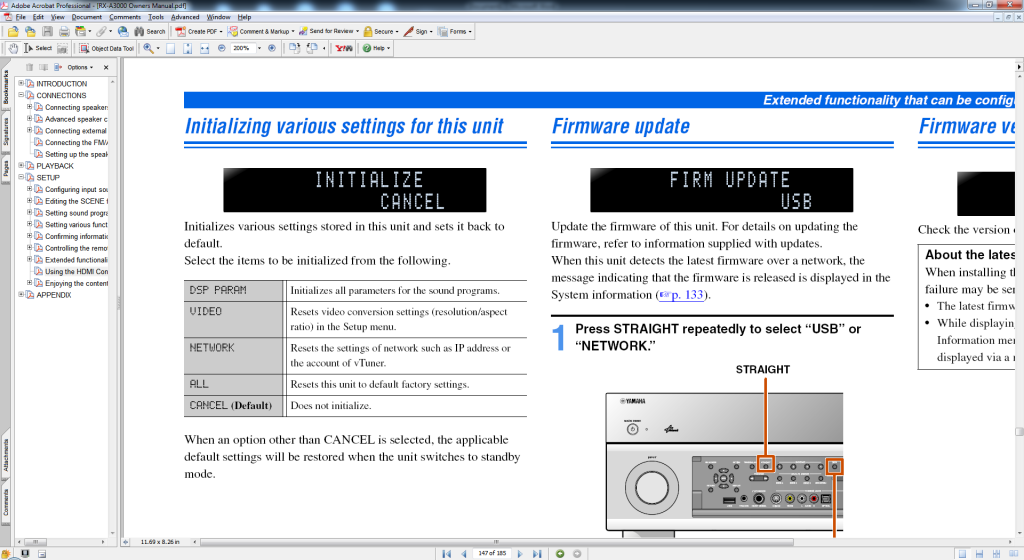

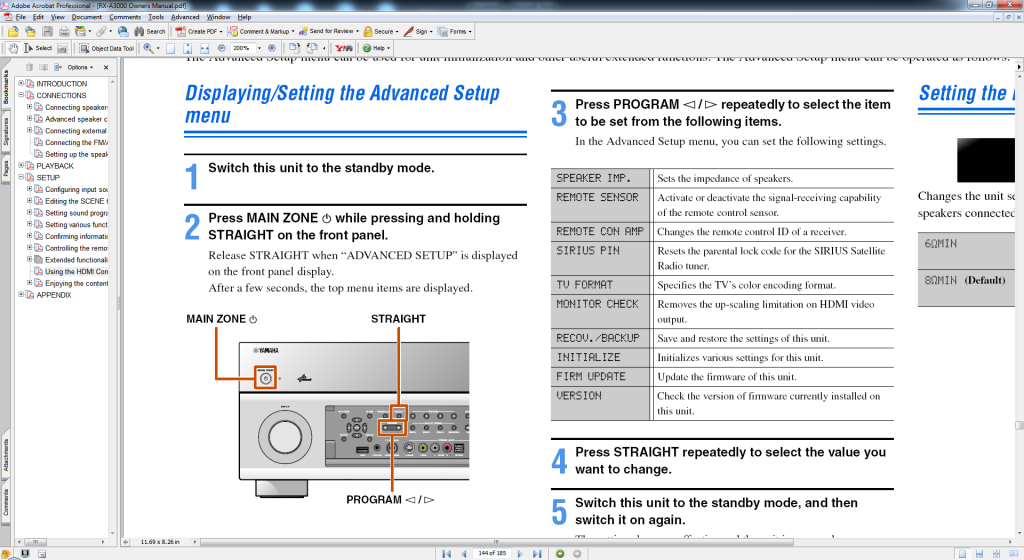

M Code
M Code
Check page 147 in the Operation Manual...
It in the OSD under Intialize, select ALL.
This will return the AVR to its factory default settings, Station presets, Scene, Audio EQ...
Just my $0.05... ;)
Ponzio
Ponzio
Initializing (reset to factory default settings) the Yamaha RX-A3000
Page 144 will guide you thru accessing the “Advanced” menu to get to the "INITIALIZE" option.
Page 147 shows next menu options. Choose “All”.
