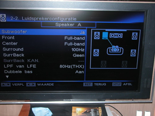

I have to turn up my speakers really high to get a good performance out of my speakers. Just when listening to the radio it's really quiet.
Also i have a problem when i'm watching a movie, the surround quality. I'm only hearing the sub and front speakers, nothing from the DS3 speakers. When i come up really close to them you hear they're working, but not as much as i expected. Am i doing anything wrong?

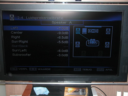

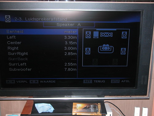

Check the delay setting for the surrounds. The manual should have a section explaining this and how to set it. Also check the output levels for the surrounds to make sure they are consistent with the front speakers. Audyssey usually does a good job with this but is known to get things wrong from time to time.
An SPL meter from Radio Shack will let you check the levels. It's only 35.00.

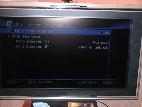

Give us some more info on room dimensions and maybe some pics on how things are set up as well as what the Onkyo's settings are this could help us troubleshoot more.

I have to set it to -20dB to hear the frontal speakers well enough for movies. When listening to music it's set to -35dB.
The subwoofer is behind the television set, that's why Audyssey placed it so far away i guess. And accoring to the manual i had to place the back speakers on the side outputs when working with a 5.1 set-up.

If your levels are properly matched and to the so called reference level, then that -20 is about right and might be on the low side:D
Usually, others have it as high as -10 or -5 to get it closer to theater reference levels:D
Yes, CD music volume will be different for comfortable levels. Don't use that as a guideline.:eek:

If you are having issues with the surround channels even after an auto calibration, you should invest in an RS analog SPL meter and do a manual level matching with either the internal test tones, or a test disc that may and should have a more accurate level signal to all the channels; it would also account for any signal path difference between the channels all the way from your DVD player to the speakers.
