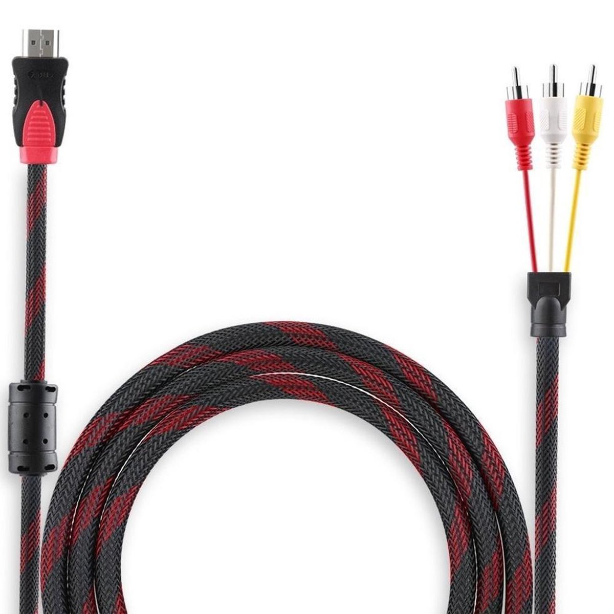

Does this mean that a HDMI to tulp converter would not work? Since the one is analog and the other is digital?
Or not necessarily.
I was thinking about ordering the following cable. It only does not have an Pr/Pb cable but if I am right, the most important ones are the R and L sound cables anyway.

Does this mean that a hdmi to tulp converter would not work? Since the one is analog and the other is digital?
Or not necessarily.
Not sure at all. Better research before just buying things to revive a very old unit.
Or not necessarily.
Those don't work, and are a fraud. Honestly those old receivers before the analog sunset are pretty much useless and worthless. You can extract HDMI audio, but that is about all legally. You are up against Digital rights management laws. To do any analog to digital or digital to analog, requires an active conversion. That means a unit with electronic components and a source of power.
I think that the HDMI audio is all I need, or would that mean the quality of the sound would not be good?
