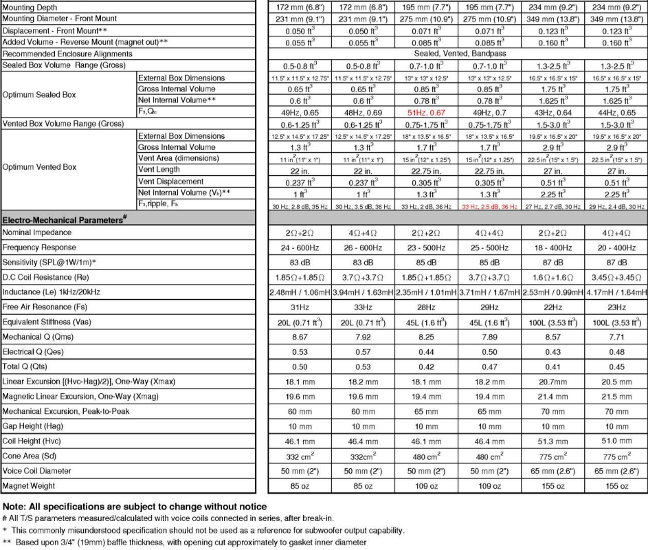

Lucky for you, all the info you need is right here.
Your driver is the fourth column from the left. It's a dvc 4ohm+4ohm woofer so you have a couple different wiring configurations you could use, but we're talking boxes right now! That chart tells you the recommended internal volume for a box, sealed or vented. Looks like you want 1.7^3' for a vented box with that speaker. They include port size too. The screenie I took has everything there. Hopefully someone with a little more diy skills will poke their head in here and take a look.
I am busy at the moment so I don't have time to model it, but at first glance that sub will work best sealed. Fs is 29 so it wont' play lower then around 35 Hz. Qts is 0.47 which in on the high side for a ported box. So it will incline to boom in a ported box. Alpine are car audio people, and so car drivers are generally designed for sealed application. Sealed, this unit has an F3 of 49 Hz so there will not be much bass in a sealed box without Eq.
So in the optimal sealed box it needs Eq of 12 db per octave starting at 50 Hz and a 12 db per octave roll off below 25 to 30 Hz at 12 db per octave to prevent driver over excursion.
