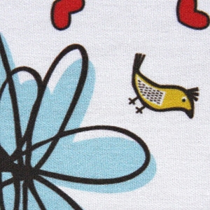

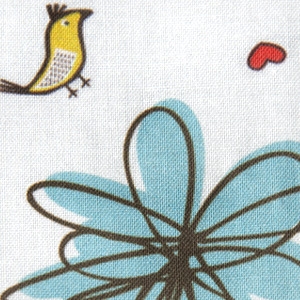

I built some sound panels recently and have been trying to figure out what fabric to use... Caveat, I am using Spoonflower to do some custom prints. I did test swatches in basic cotton and satin. Cotton passes air better, but detail/color isn't as good. Satin looks much better, but is shiny and doesn't pass air as well. I didn't get a test swatch of the cotton poplin, but is probably a good compromise between the two.
Thread count:
Basic cotton - 78x76
Satin - 165x79
Cotton poplin - 133x72
Pics:
Basic:
Satin:
Poplin:
Thoughts?
