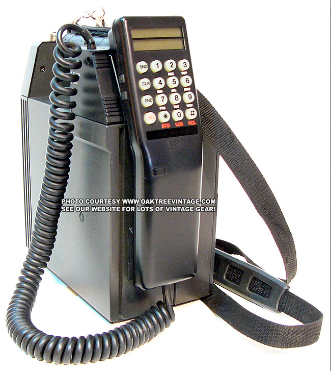

What you are missing is the equivalent of using this:
vs this
With Dolby Prologic, your capabilities are now two generations behind the current technology, and the difference is quite significant. If you happen to have a receiver with multichannel analog inputs, which many pre-Dolby Digital era receivers did have, you may only need to upgrade to a player that has built in decoding and be able to benefit from even the latest audio formats.
