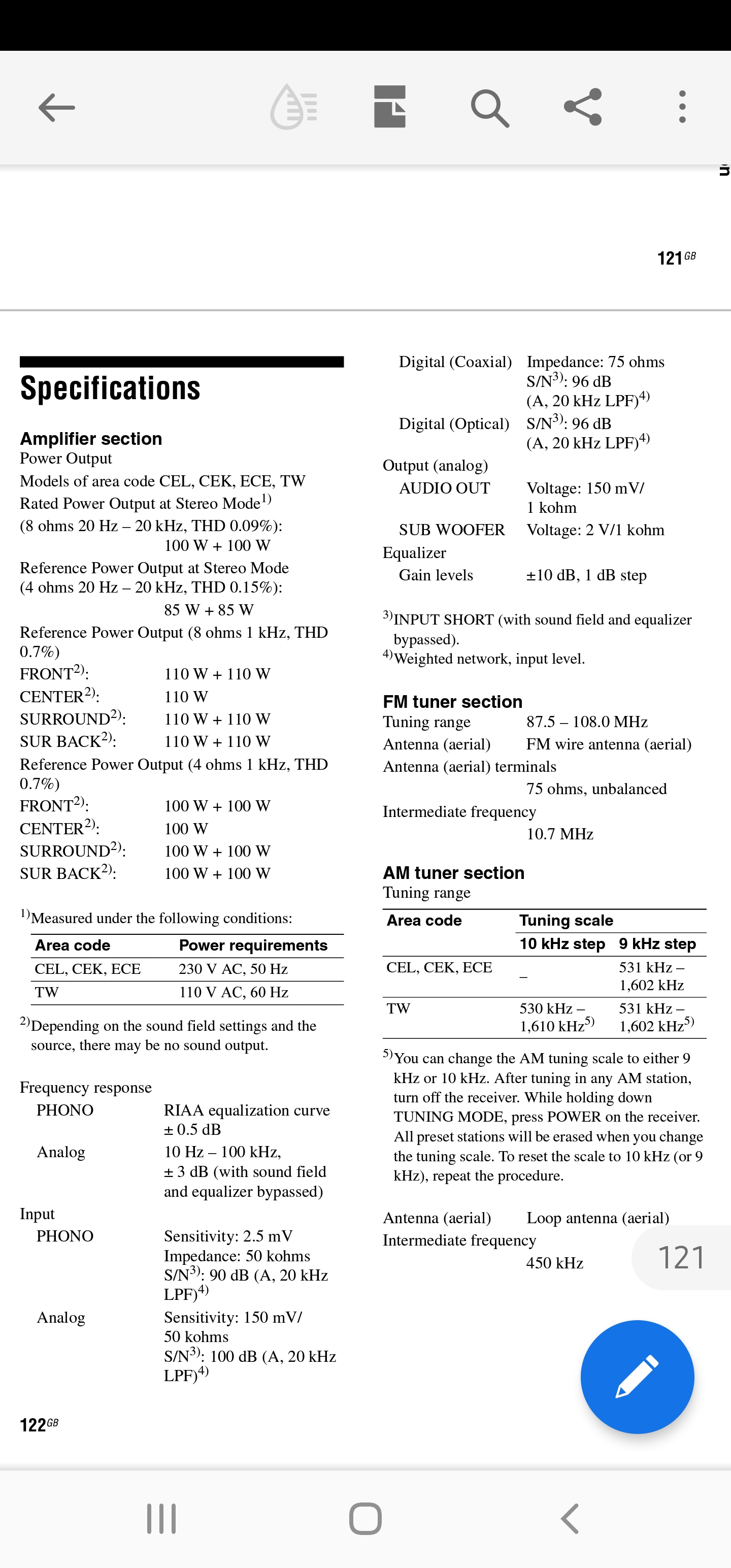

I can a Sony 2400es and the specs show the preout voltage is 150Mv/1kohm. I just got the anthem 325 power amp for my front 3 speakers. I will be getting the anthem 1140 down the road but for now would it be damaging anything on the power amp where the Sony got such a low perout voltage?
I can a Sony 2400es and the specs show the preout voltage is 150Mv/1kohm. I just got the anthem 325 power amp for my front 3 speakers. I will be getting the anthem 1140 down the road but for now would it be damaging anything on the power amp where the Sony got such a low perout voltage? View attachment 58393
I have cross checked that spec. and it seem to be correct. I have have never seen such a low pre out output voltage. You will not damage anything, but you will get a very low volume of sound from your speakers. If you want to use that anthem then you need to replace that receiver, or your power amp will not be any use to you.

Ya it is low forsure but I still hear a difference in sound forsure but ya have to turn the amp up and it still sounds clean and loud. Big difference in movies for sound also. Ya when I get the anthem 1140 then it will really shine but as long as I'm not damaging anything I'm good. Thanks

I guess that's why I didn't have to adjust the levels in the avr when I got the 325 hooked up. They were still at 78db from just the avr and the power amp. I thought that was strange but now I know.

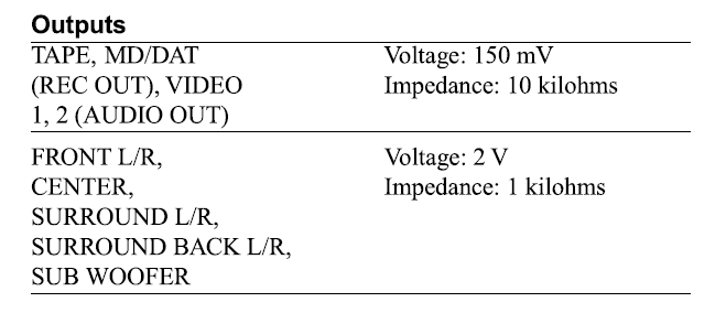

That 150 mv is not the pre out spec. It is "analog output" for you to connect to a recording devices etc., but not external power amplifier. The pre out specs are not given in the manual.
It the pre out spec was included, it would likely 1 V, 1.2 V or 2V.
For example, below is for the older DA4ES, 7ES and 333 ES, I have no idea why Sony stopped providing the pre out voltage for some of the newer AVRs, perhaps they were concerned that such specs might confuse people.
In the case of the DA4 ES, 7ES and 333 ES, the pre out specs show 2 V, with load impedance 1 kOhm, that is very good.
Typically speaking, when pre out voltage specs are provided, manufacturers don't specify the load conditions but a reasonably assumption is that it is the voltage needed to output the AVR's rated power output. For example, Yamah AVRs are often specified to have pre out voltage 1 V, but we all know they can output much higher, from 1.6 to well above 2.5 V as shown in many of Audioholics.com bench test.

So maybe it's 2V like the subwoofer one is? I am getting louder volume forsure but I guess where it's an older sony it's still holding it back?
PENG
That is a very reasonable assumption. Holding back what?
