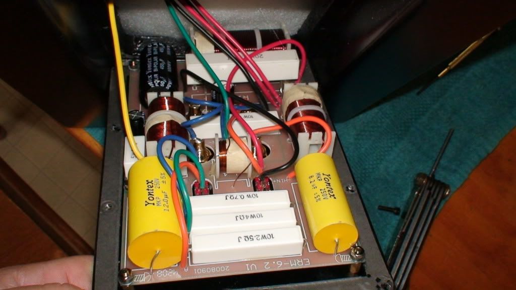

Perhaps Polk could learn a few things from Dave Fabrikant. Just look at this beauty:
Now, that is what I call a X-over! Make no mistake the 340's are exceptional speakers. ;););)
There is nothing special about those crossovers, it uses the same grade of parts used in the LSi9's crossover.
The x-over parts in the LSi9 are not the best in terms of quality by any stretch of the imagination. To me, it is pretty obvious that in order to get their costs down they went with cheaper parts. If you look at the upgraded x-overs in the Polk forum the difference is very obvious.
Correct, and it's something that can be easily fixed.
