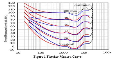

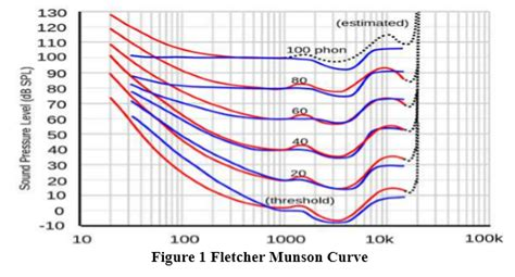

This image shows the approximate abilities of humans to hear- it shows the required SPL for the frequencies to be heard equally, so higher means it needs to be louder. If you invert the image, it shows that we aren't very sensitive to low and high frequencies, but the midrange is where we need to be most sensitive- evolutionally, there's very little that would require us to hear well at the extremes- speech, dangerous animals, listening for prey and other sounds is more important for our survival.

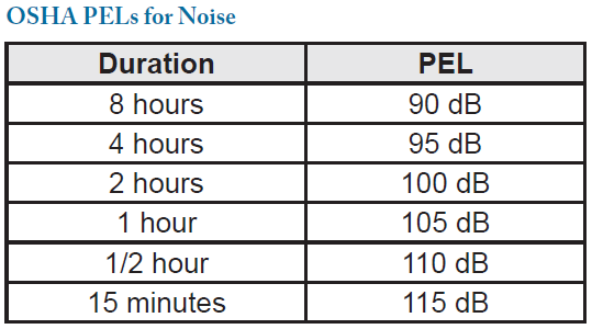

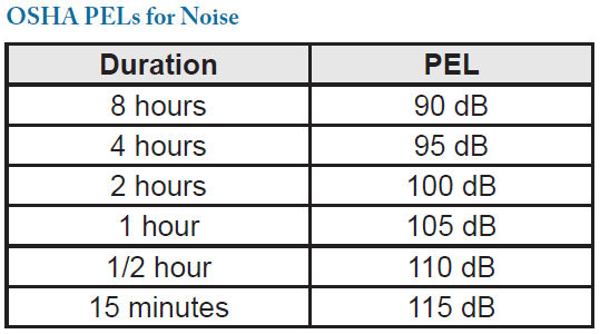

This shows the allowed noise exposure, from OSHA. If you look at this and compare it to the levels people say they want in their home theaters, you'll see that they're risking their hearing.
