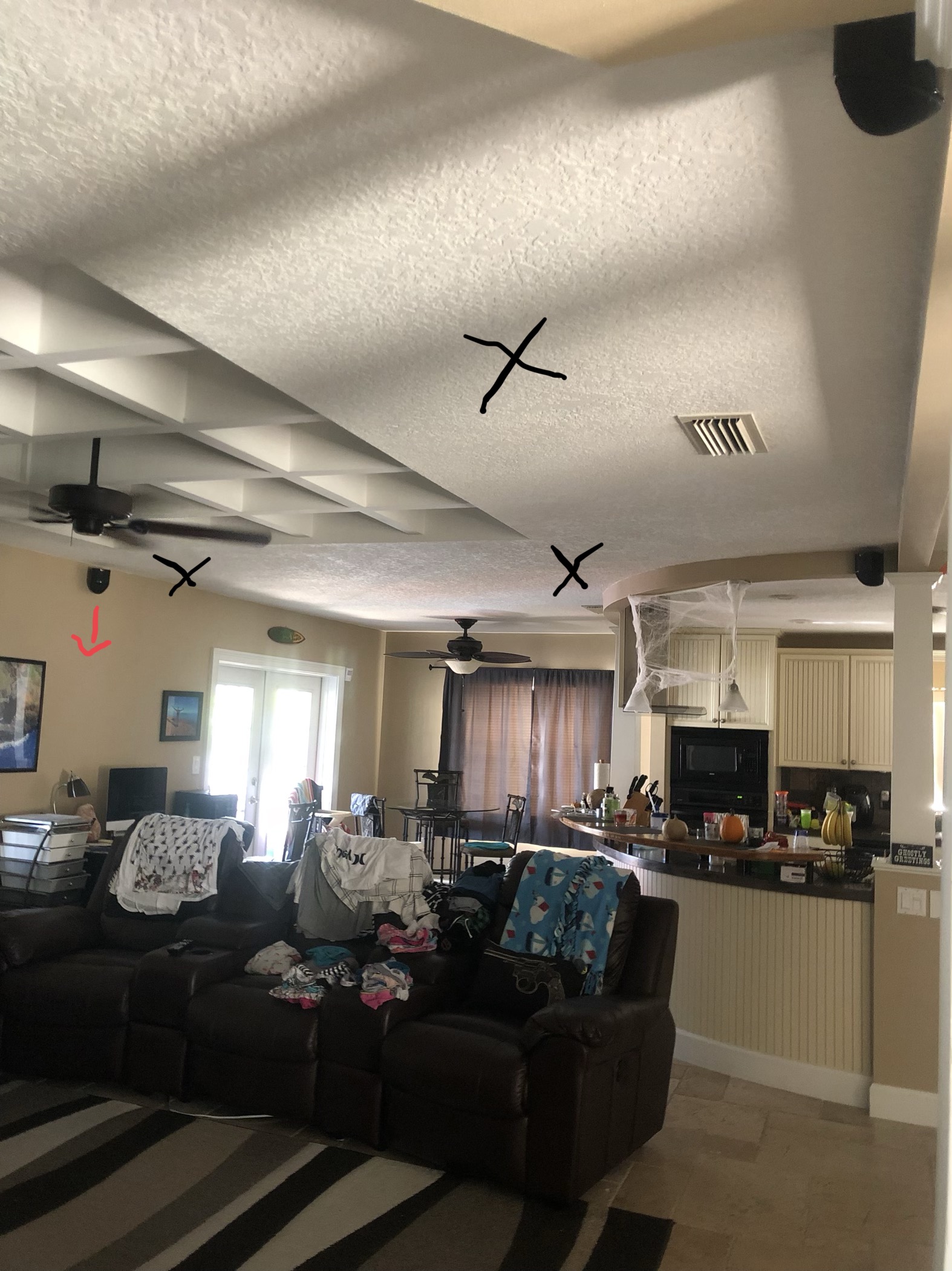

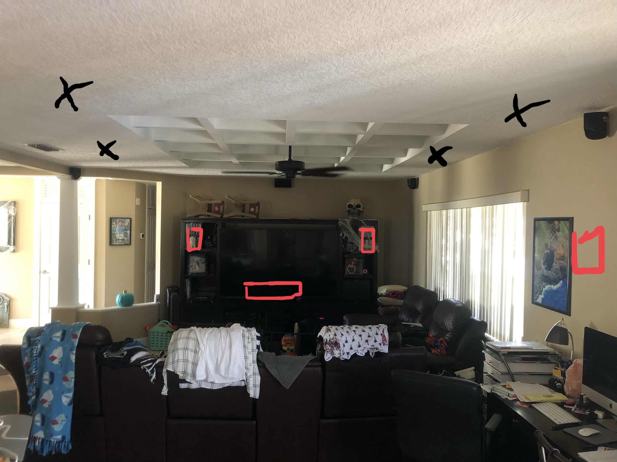

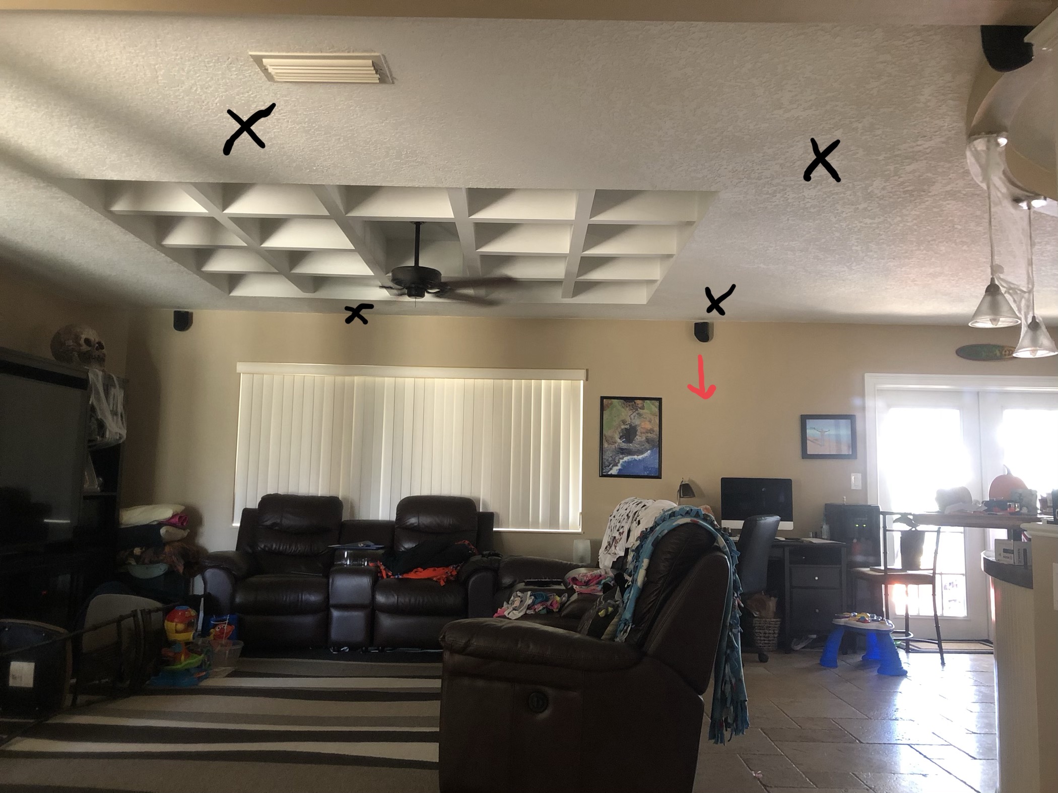

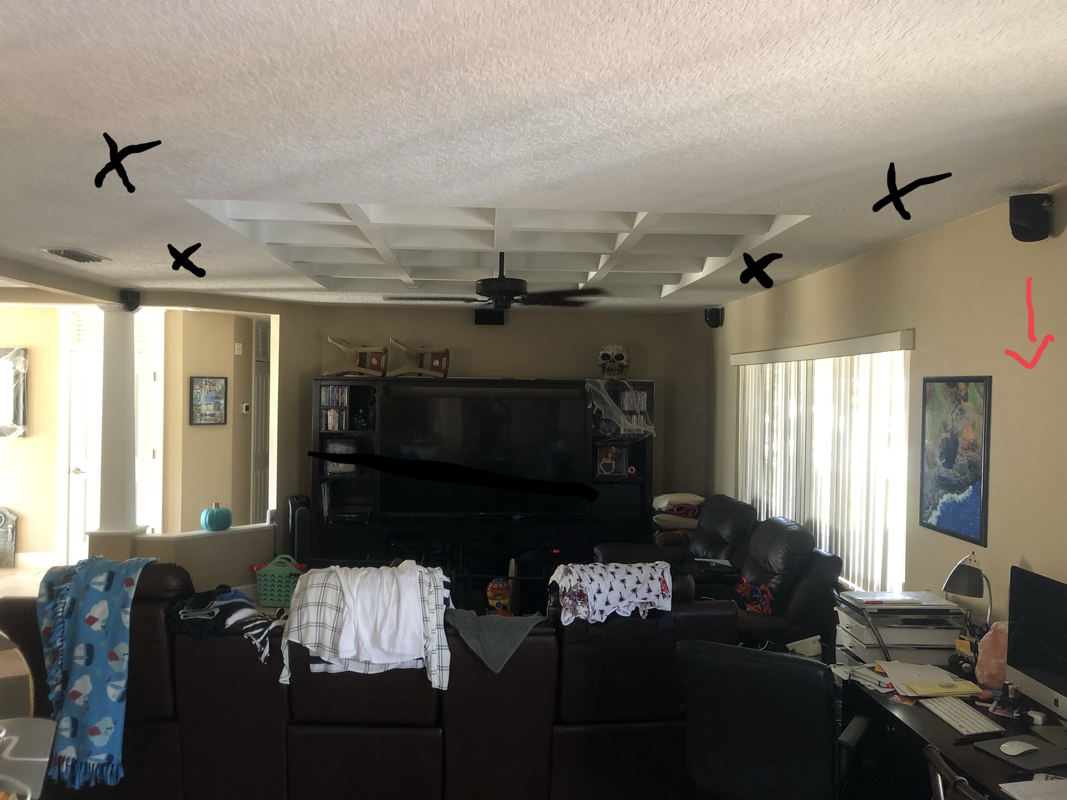

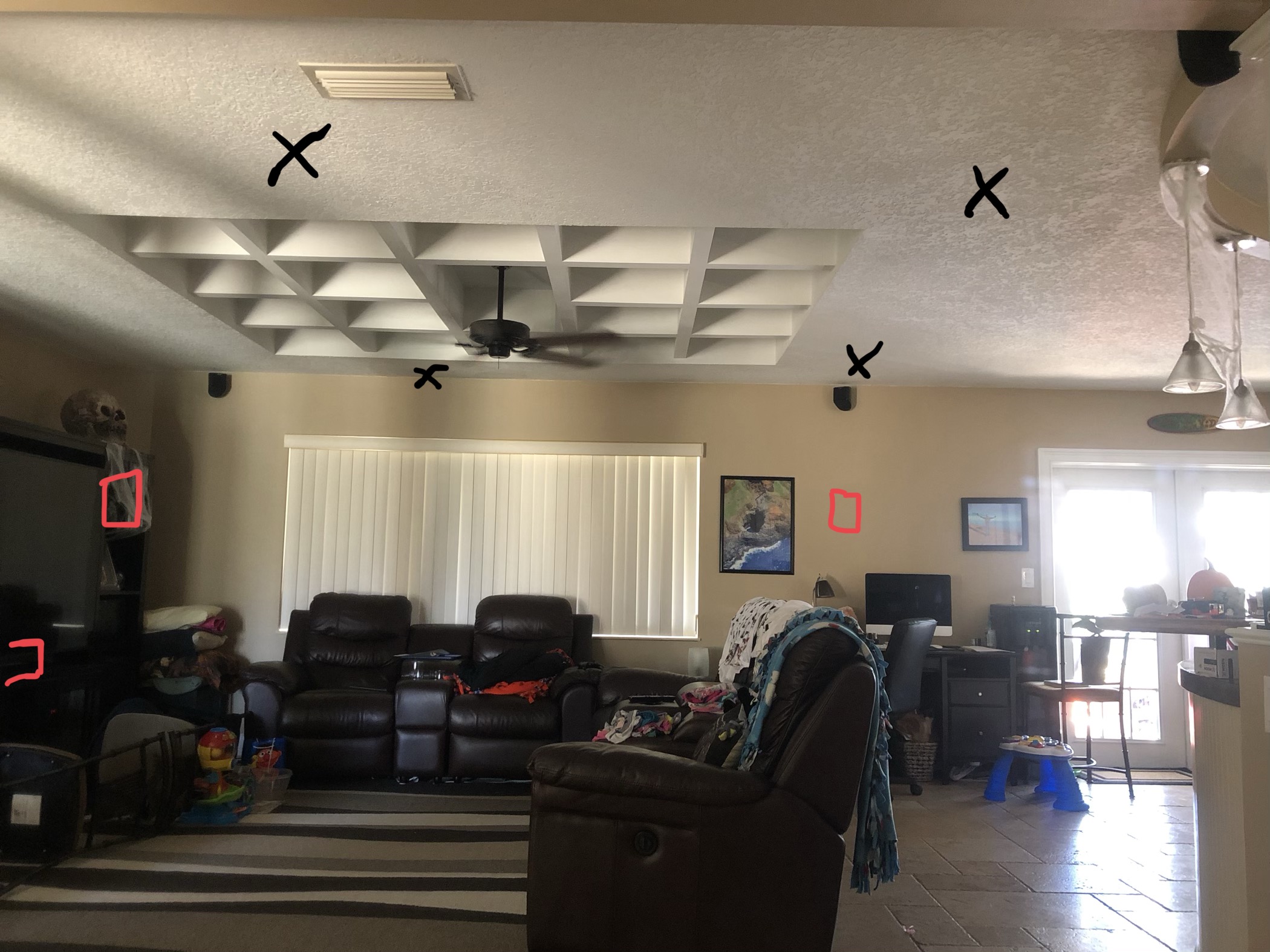

Ok. I ran home so I could take some more detailed pics. As seen in photos I can move the rear right surround down closer to ear level but the left surround isn’t really movable away from the ceiling. I have a little leaway when it comes to rear heights placement. The rear heights as marked in photo is about 2’ behind the couch and is about 3’ away from the left rear surround. If I move the rear heights back farther they will most likely have to be brought in 1-2ft closer to center rather then be in perfect alignment-array with the front heights.
Hope this helps clear up my issue.
Excuse the mess, it’s laundry day! Thanks

I don’t have time atm to do any markup on the photos but if it were my room I would move the right surround down, AND back a little bit. Move the left surround possible down on the pole(practically notwithstanding).
The other thing is your front speakers have to come down, or Atmos won’t work. Iirc off hand the spec says the height speakers should be 2-3 times the height of the mains above the mains. Ie: if the mains are at 40”off the floor, ideally the heights will be at 100-120” above that. Obviously that can’t work for every room, but having them all on the same plane won’t work at all. I’ll try to look closer later. Sorry if that was covered already. Multitasking....
