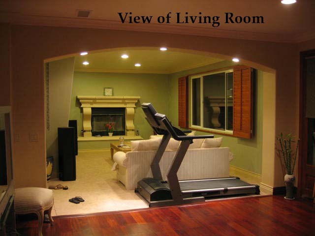

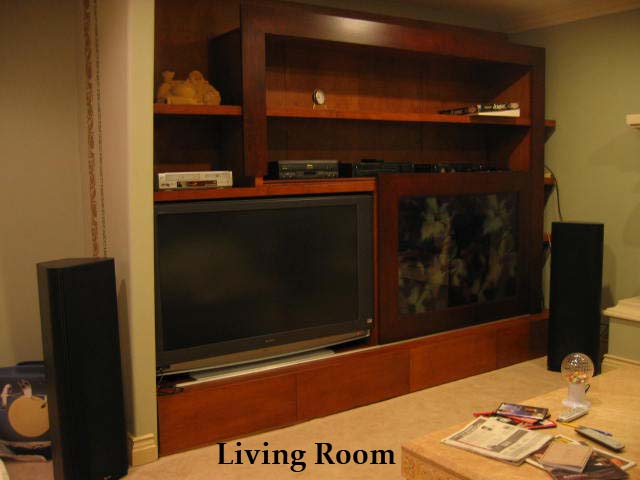

Living Room: Main Room with 5.1, 75% Movies, 25% Music
- Existing Sony 60 inch TV
- Denon DVD-1720 $135
- Denon 3805 $900
- Left and Right Channel: Existing Pair of Infinity Kappa 7.1
- Center Channel: Infinity Primus C25 $162
- Surround Backs: Pair of Infinity Primus 150 (Free w/ Infinity purchase)
- Sub: Infinity CSW10 $540
- Dayton Optical Cable from DVD Player to Reciever
- Dayton Component Cable from DVD Player to TV
- Dayton Subwoofer Cable from Reciever to Sub
- Wires for L/C/R/surround already set up for speakers
- B-Tech BT1 Speaker Wall Brackets $30

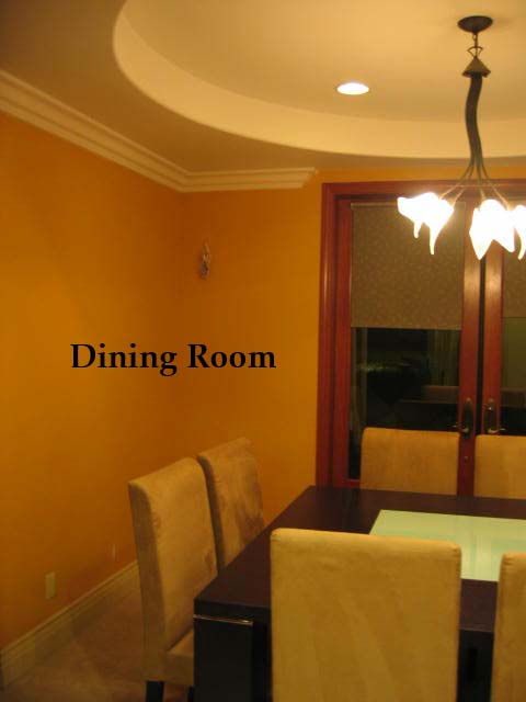

Dining Room: Ambient/Soft music, mostly classical with 2 Speakers
- Pair of Infinity OWS-1 $180
- He wants thin on wall speakers without the hassle of an IN wall…
- Wires are set up, just sticking out of the walls waiting for speakers

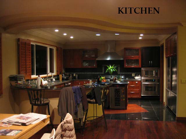

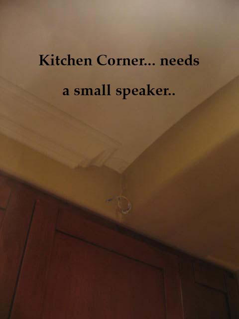

Kitchen: Ambient/Soft music, mostly classical with 2 Speakers
- Thinking of the Infinity TSS-SAT750 $180
- Not sure about the sound quality from these… recommendations are appreciated… but must be a small set of speakers
- B-Tech BT33 Speaker Wall Brackets $30

He was running the Infinity Kappas 7.1 with these:
- Carver Sonic Holography A/V Preamplifier Tuner CT-3
- Carver Magnetic Field Power Amplifier TFM-35
The Living room is 12'x17'9'
