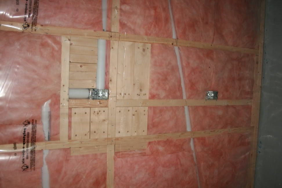

It's too bad too, I definitely had the wall strength and the studding put in for it...

One thing to be aware of is how the wall plate fits in relation to your studs. I have the Sanus VMPL and I had to drive the outside screws in at an angle to be sure I was catching the studs.

Most of the wall plates I've worked with - wait, take that back, ALL of the wall plates I've worked with have slotted openings for the lag screws to pass through, which helps you center the plate itself, even if the studs aren't centered for your viewing purposes.

I should clarify. The first time I attached my mount to the wall, I tried to center it on one stud and catch a total of three studs.
Originally I mounted the TV too high so when I lowered it, I shifted it over and just attached it to two studs. That's still plenty of support with those big lag screws.
