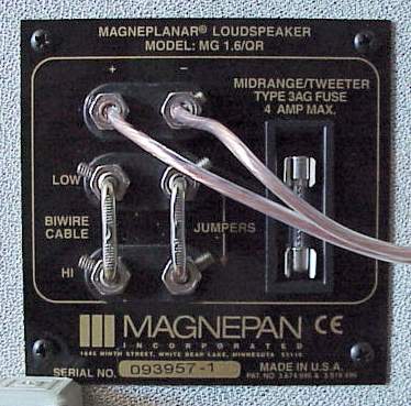

As for the adapter, the Magnepans I've used will accept either bare wire or banana plugs. Not spades. Below is a picture of the binding posts on a MG1.6QR. As you can, it works fine with bare wire, and would also work with Banana plugs (probably the expanding kind would be best).

1. I heard the Magnepan need some kind of adpater to be connected with normal speaker cable? what is that actually?
False. Standard banana plugs work perfectly fine.
