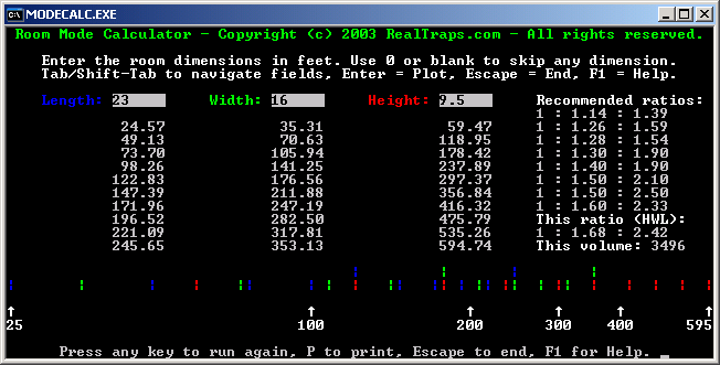

Just wondering about room ratios as I havent come across them before. Could you point me in the direction of some information? Thanks, Ryan.
Ethan Winer
Ethan Winer
> Just wondering about room ratios as I havent come across them before. Could you point me in the direction of some information? <
The screen shot below (click the link) is from my Acoustics FAQ, and it shows eight ratios commonly accepted as "good" for bass response. Understand that having a favorable ratio is only half of the equation. A room also needs to be large enough for the modes to be close together.

It's actually less about general room ratios, and more about the relationship between the specific dimensions of a room. The oft-published ratios, like the ones shown above, are very rough guidelines, but they won't produce the best possible results in most rooms. There are better tools:
John Griggs' ModeWizard is a great java tool with good accompanying documentation. It gives you the best dimensions within a user-specified range, and can make the evaulation based on many different room evaluation criteria. It will actually give you a list of usable dimensions. Much better results than those got by blindly applying the so-called "ideal" ratios found in many texts.
RPG's Room Sizer is a great tool that also optimizes the room dimensions over the given range considering different parameters. This one will set you back some $$, though, FWIW. (If you're only going to have to figure up your room dimensions once, I would suggest Griggs' ModeWizard.)
Personally, I also am partial to the Griggs tool because of its wide array of criteria to choose from - Bolt, EBU, Bonello, even one Griggs developed himself.
To reiterate, the current line of thinking on this is that the textbook ratios are quite limited in their usefulness. More folks are turning to tools like Room Sizer and ModeWizard to help figure up the best room dimensions for good distribution of modes.

Thank you Jeff and again to Ethan. Ethan- I found the FAQ handy, I'm sure I will try to pick your brain more when I have studied it further if you don' t mind. I'm am finding this forum a great source.

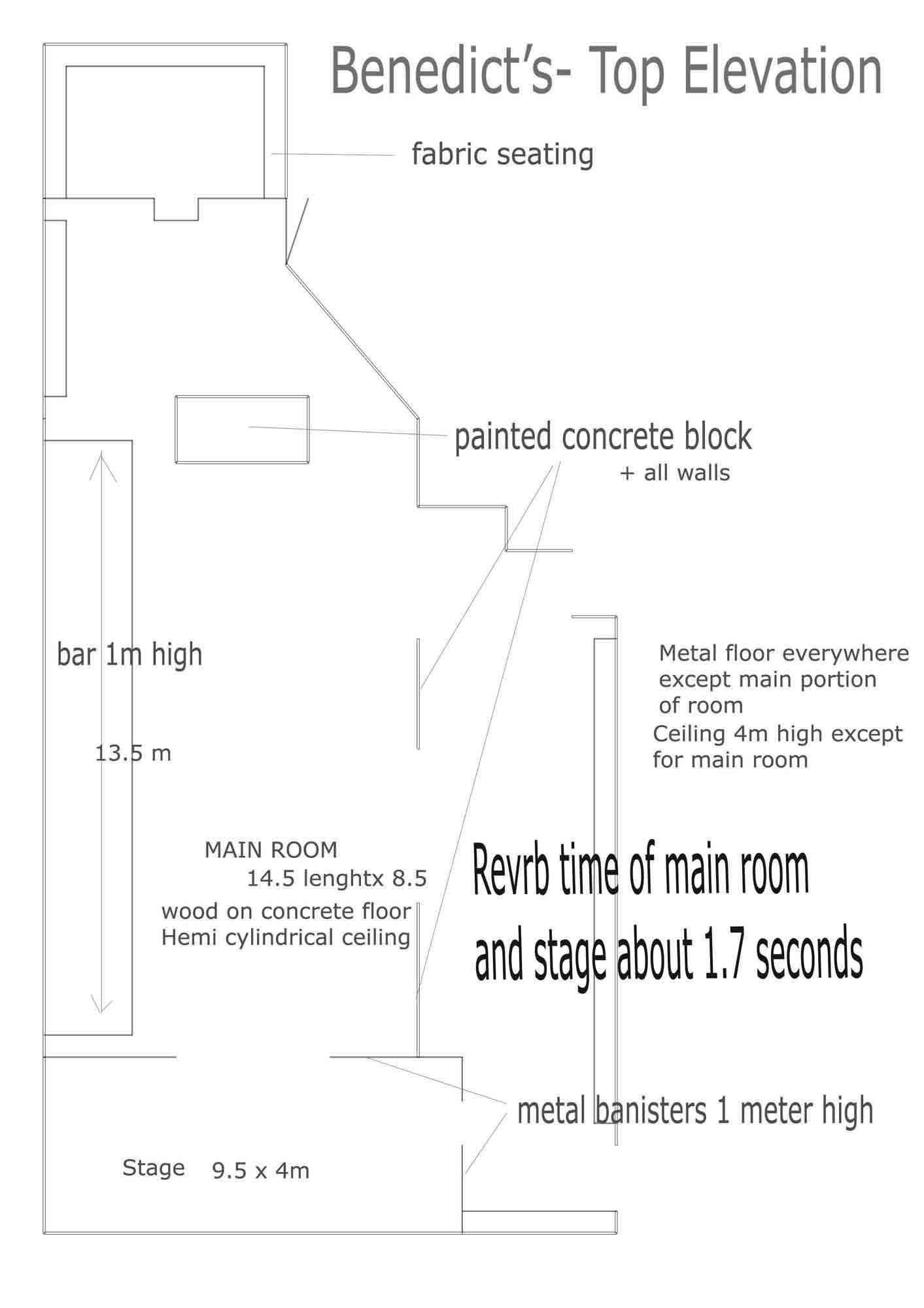

I'm currently studying a complex space if you have any suggestions. It's a nightclub with a big grim reverb time- around 1.7 seconds, and Im attempting to suggest treatment for it for a school project. The style and the atmosphere have to be taken into account so I can't go over board. The ceiling of the larger part of the room is hemi- cylinderical with a radius of 4.25m/14ft. I am mainly interested in treating the main room and I am going to work out the effect of treating the back wall of the stage and cutting out the hemi ceiling, making it flat as its already 4m high. I was going to suggest a single point source supended over the stage and main room boundry at a coverage angle that would just cover the dance floor. The stage behind the main room is raised by around .5 of a metre and has a metal floor. If you could suggest any treatments or criticise my plan it would be appreciated. the pic is an attachment.
http://forums.audioholics.com/forums/attachment.php?attachmentid=3055&stc=1&d=1147098158
Thanks. Ryan.

griggs mode calc
Jeff,
I had a chance to mess around with Griggs Calc. I'm on a Mac so I couldn't get the others to work. Thanks for the heads up it seems like a neat application. Ryan.

The general goal for reducing reverb in any space is to use absorption that's effective to as low a frequency as possible, spread around the room evenly. If you can identify a single large area as a specific source of echoes, or perhaps focusing as from the dome ceiling, those could receive additional absorption or even complete surface coverage.
--Ethan
