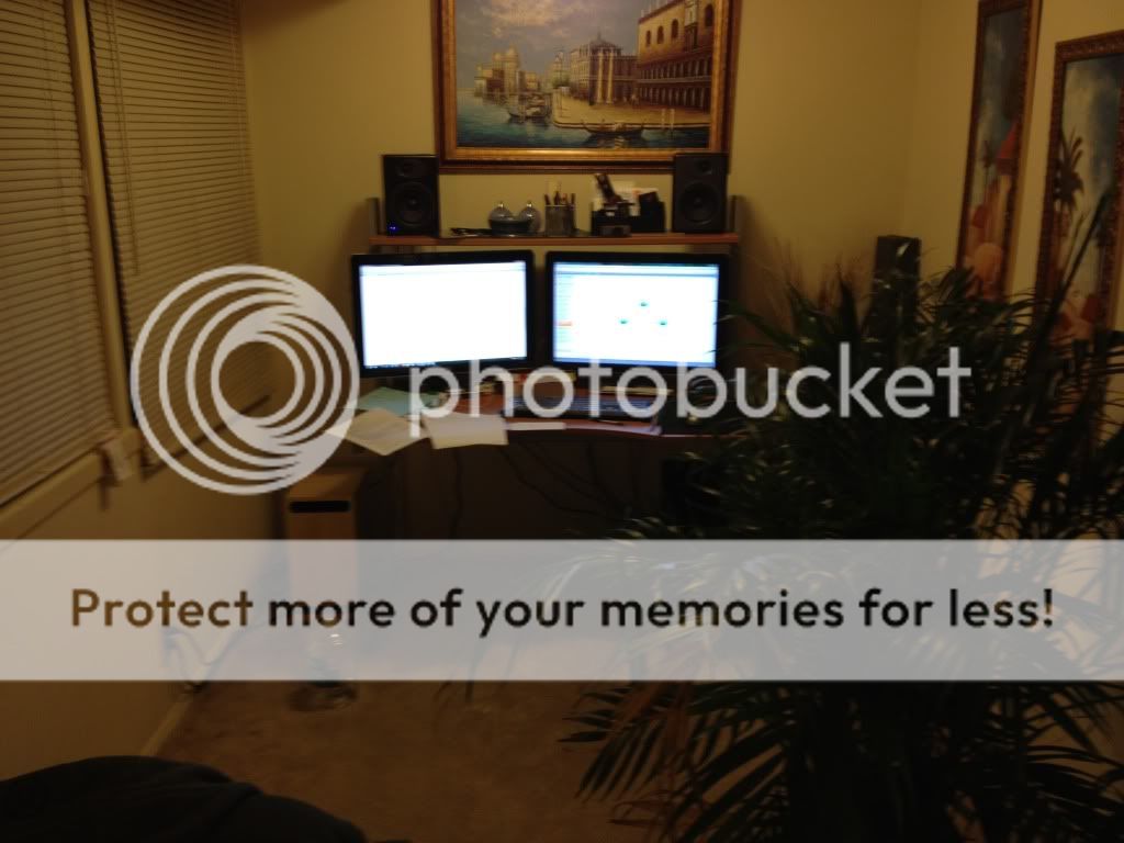

Step one: better subs. Forget the expensive JL sub, and consider less expensive smaller sealed 12" subs (plural; you want at least two). You will probably not get the 20 hz extension, but you'll get much better dynamics and smoother in room response everywhere above that. Depends on if music or low freq sound effects are more important to you. I like music myself, don't think I'll ever watch Optimus Prime drop a car on anyone.
Step two: miniDSP or something to integrate subs perfectly.
Step three: play with speaker placement and room treatments. Just looking at your pics, the speakers are too close together for much stereo image beyond your desk chair. Space 'em wider, toe in a bit more, treat first reflection points, etc.
Then, if you really want to shred your ears, get more dynamically capable mains able to keep up with your newfound bass performance.

I'll get some 30" Sonus Speaker stands.
I'm looking for the best build quality possible in my gear. Any suggestions on these cheaper sealed 12" subwoofers of smaller size. I was under the impression the Emotiva Ultra 12 was 'cheap' ~$500-600?
