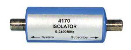

That may not work. It will not work with satellite systems as it will not pass the DC phantom power. It might not pass the digital signatures of a lot of cable systems either. Comcast Xfinity can only be split twice and with very high bandwidth splitters. That transformer will count as a split assuming it even has the bandwidth.

I have had this problem pop up when I was at my previous address. I used both Comcast and Wide Open West and it solved the problem on both. Same type that was suggested earlier, just different company
https://www.amazon.com/gp/product/B0017I3K9M/ref=oh_aui_detailpage_o00_s00?ie=UTF8&psc=1
I would try this and if it doesn't work, Amazon has a liberal return policy
It would be worth a try, may or may not work depending on the setup.
When I had this problem with a poorly grounded coax from the cable company, I was able to solve the problem by using the in/out coax connections on my surge protector power strip.
