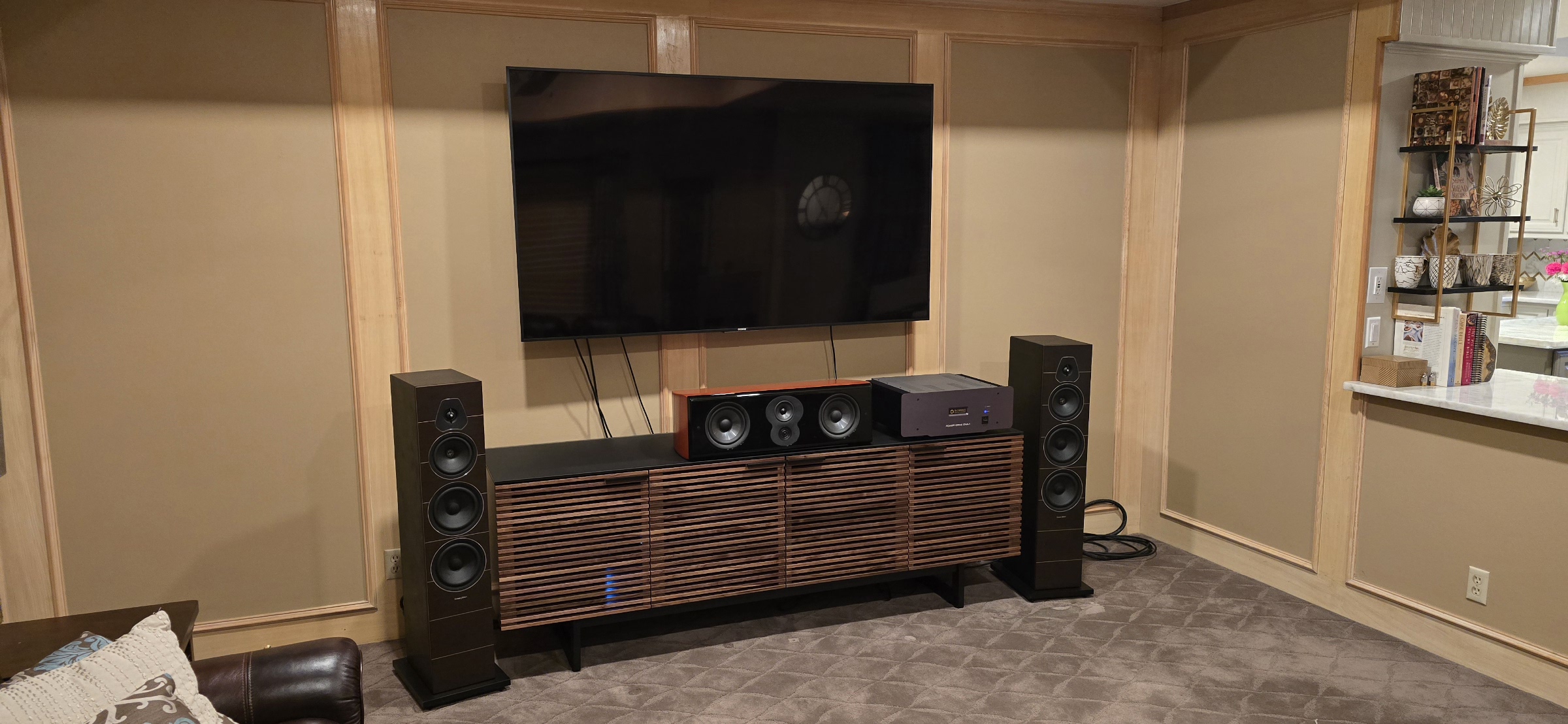

First, this system is in our mid-sized family room and my listening mix is 50/50 music/movies, 5.1 for movies, 2.0 for audio listening. My setup includes an Anthem STR preamp and I use the Home Theater bypass feature for movies. For two-channel, I have an Anthem STR preamp, which is connected to a power amp. Up until now, I have been using a massive Krell FPB 400cx for my fronts, so I don't want to either step down much in audio quality or break the bank replacing it. The reason it has to go is that we just got a new BDI equipment console and the Krell will not fit inside and I don't want to put the 100 pound beast on top of the BDI's glass top, either. It appears that I might be able to squeeze the A21+ into the BDI.

You bought the wrong console. However, you can place power amps anywhere. They don't even have to be in the same room. I would try and solve this without a huge downgrade.

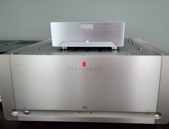

A good and more affordable alternate product is the following high efficiency Class D Hypex amplifier, and from a reliable seller:
Lol, not very helpful. Are you saying you know of one that will hold my Krell? And that my wife would accept? I looked around quite a bit and didn't find one.

A good and more affordable alternate product is the following Class D Hypex amplifier, and from a reliable seller:

The class D amps are not “one” amp but many different amp modules the most powerful would be the Hypex NcoreX modules or the second generation Purifi modules. These are much smaller amps, run cooler and have the better bench measurements than the older Class AB amps.
The above give you some examples of reviews with many measurements.
But I also came from Class AB anthem amps. The below string turned me into a class d believer. PENG is short for professional engineer (retired EE) who is a respected advisor on many forums. This string details his conversion. But I know giving up the past is hard but you only have to read the measurements. Math is math.
You missed my point. Power amps can go anywhere within reason. They don't have to be in that room. I have 9 big power amps in my large AV system, but none of them are in the AV room.
So you have to think not necessarily within the room but outside the room. This is a time to get your creative juices going.
