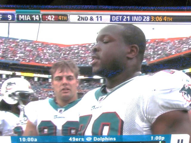

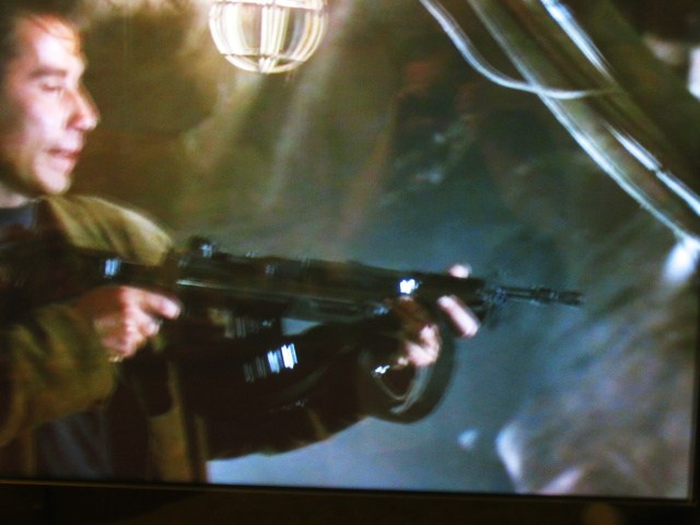

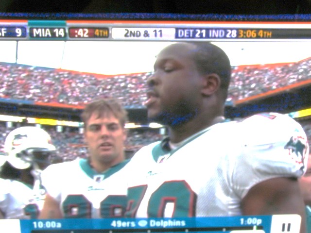

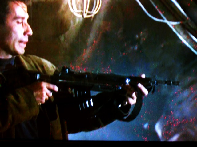

I have a 58PZ850U and I have had trouble with red Dots on the screen. I have tryed four or five different HDMI cables. I have been using the monoprice HDMI cable tryed 2 different monoprice cables. also radio shack HDMI and a now 2 different Blue jeans HDMI cable and the Blue Jeans and the radio shack cable made it even worse. see pictures below
so today I tryed componet and there were no red spots. also I had been using HDMI 1 slot on the TV and to day I tryed HDMI 3 slot on the TV and it all looked good no red spots. this was with the monoprice HDMI cable then I switched it back to HDMI slot 1 and the red spots were there. now when I put the Blue jeans HDMI cable in HDMI slot 3 on the TV I get all kinds of red lines blue lines and blue dots. I switch back to the monoprice cable and it fine in HDMI slot 3 on the TV. So Is my TV HDMI Bad Im running direct from Direct TV DVR to my TV. should I have someone come out and look at my Tv ??
