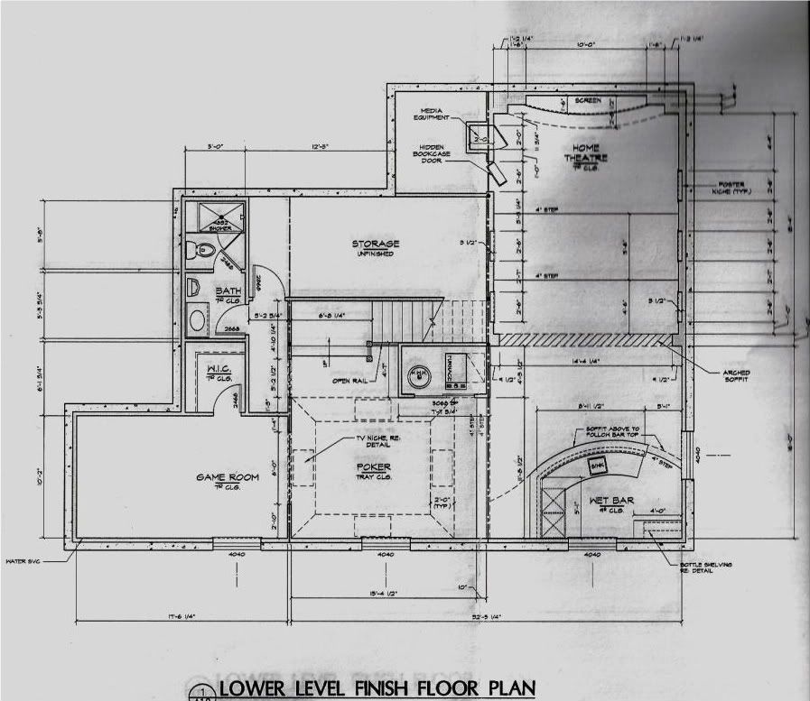

I am considering this, however, is it a pain to get to the center speaker if it is behind a mounted fixed screen? I could easily have the contractors build a niche for it in the wall behind the screen, but am wondering about the inconvenience factor. Then again, how often do you really have to mess with a center speaker once it is set up properly?
Here is a picture of the plans for the basement. Construction hasn't even started and I am already so excited!:D
