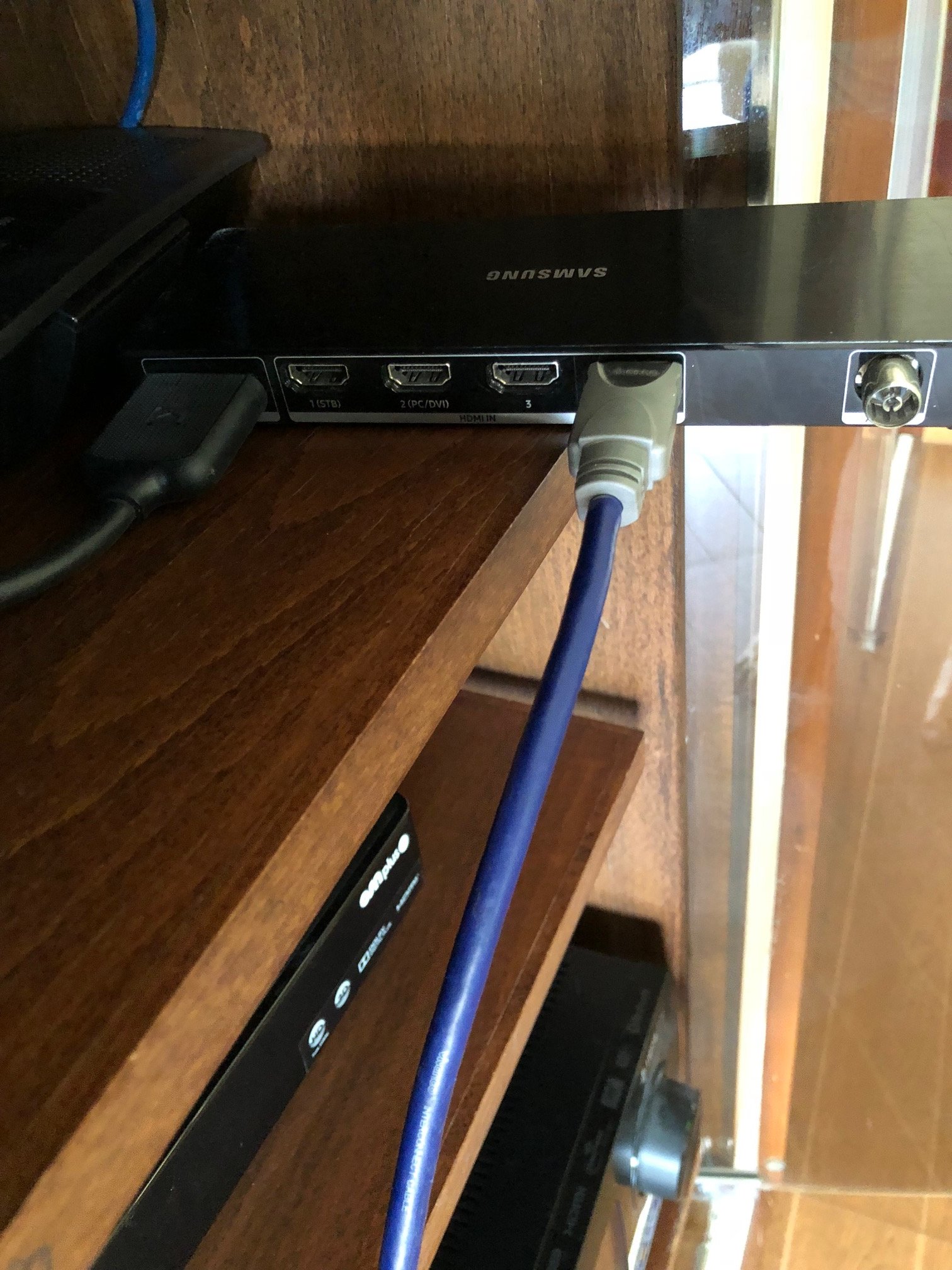

Sorry guys, maybe the term hub is confusing. Photo enclosed. This little box ( hub) connects the TV to the AVR. I connect using ARC . So the blue HDMI cable runs from the ARC to my AVR HDMI out. My devices go into the appropriate AVR inputs. All devices work perfectly , no issue when I exclude the AVR and hook the device directly to the hub.

snakeeyes
That’s the Samsung TV one connect box. It is on all the Samsung TVs. I have a 2016 Samsung. There is a single uplink propriety wire to the tv and then all the HDMI inputs are on this box that you can locate near your sources or to the receiver or both.
