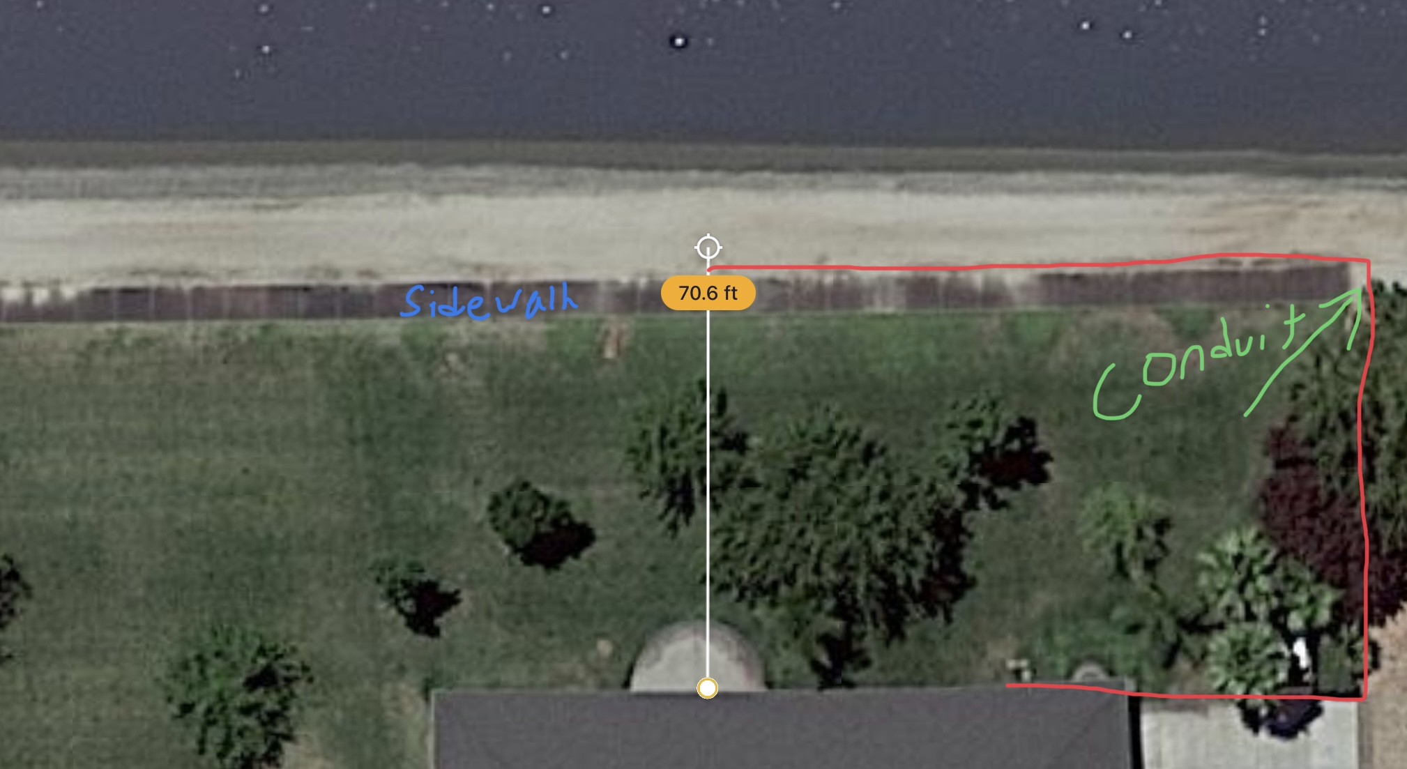

mx416
I had two concerns for running just straight speaker wire to the beach. maybe you folks can put those to rest
1. The long distance the wires would have to travel to avoid sprinkler lines and get to the existing conduit under the sidewalk. (200’-300’)
2. Getting the wires out of the house in a nice fashion, without tearing up the house or concrete around the house.

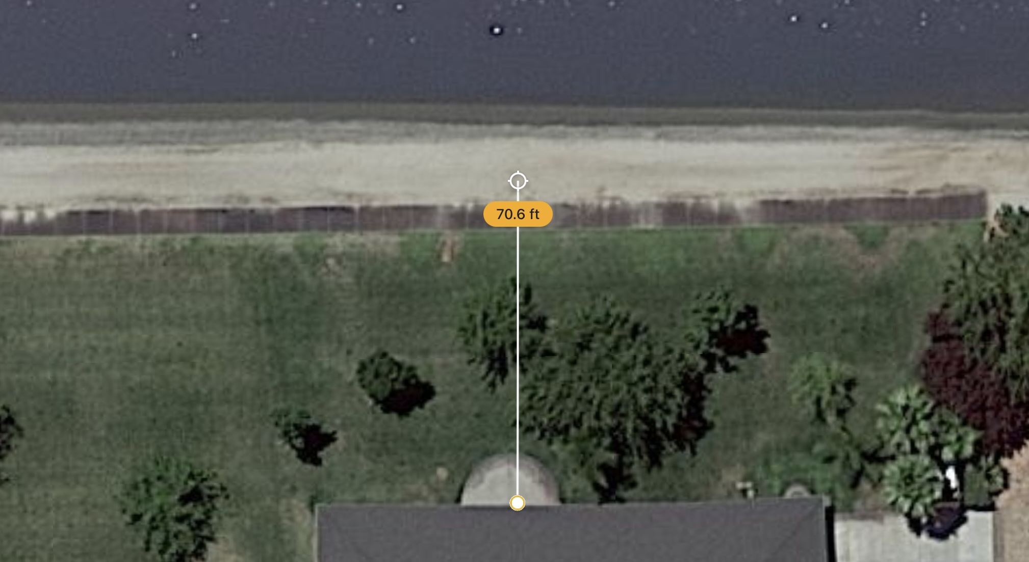

Thanks for the help!View attachment 58706
Get ready to use a trencher.
70' isn't tremendously far, but it can pose some issues for an amplifier and system.
#1 - line loss and it's the whole reason for 70V amplifiers. Wire gauge and line loss are almost immaterial and you can connect a group of speakers easily, so coverage can be better than if you only have one pair.
#2 - Lightning. Anything that's connected to a grounded system is a target/source for a large jolt that you don't want to be a part of, in any way. Your house doesn't want to be involved, either. A simple surge suppressor won't help, so you want any conduit used for this purpose to be well-grounded.
#3 - weatherproof speakers- do you want to leave them at the beach, or will they be brought in when you're done? It's not a problem if you want to leave them, but they will need to be made for outdoor use.
#4 - Synch is kind of a non-issue because it won't matter which method you use for getting the audio to the beach, you'll still have some delay. If you're at the beach and can hear what's playing at the porch AND the music playing at the beach, you'll hear that the sound from the porch will be delayed by roughly 1 millisecond for every foot of distance between you and the source. If you can't hear the sound from the porch, it's not an issue unless you're walking back and at some point, it will be unavoidable.

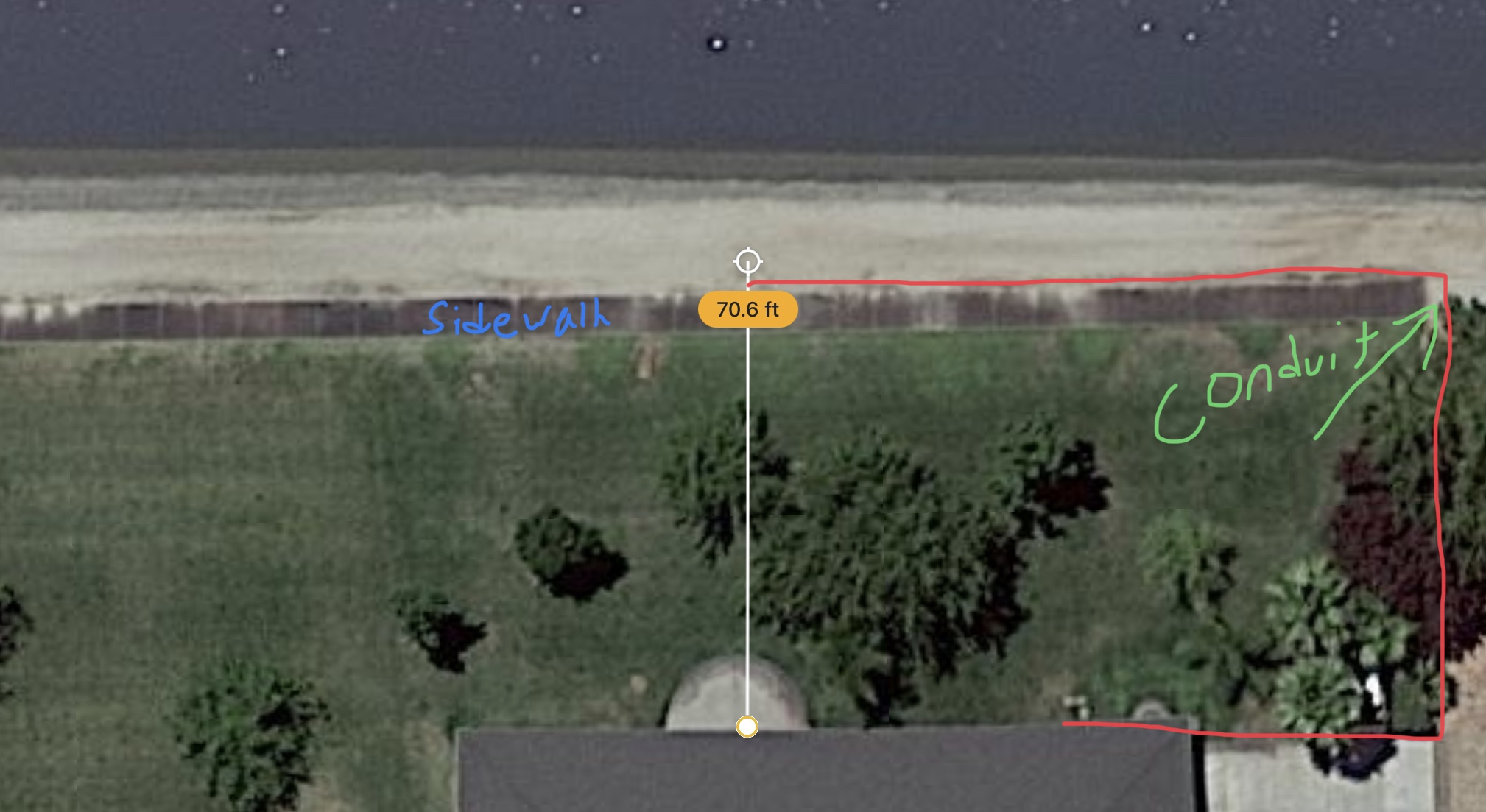

Thanks JamesView attachment 58722
That distance makes this different from what the first diagram shows- it's a good case for a 70V system or self-contained with BT.

You get it out of the house just like an electrical job- drill holes, install some kind of conduit, seal the holes and use weather-resistant junction boxes. Use flexible liquid tight metallic conduit and make sure there's a way to see where it is, so nobody digs through it. Home Depot and other big box stores have everything you would need.
You want to use speaker cable that's rated for direct burial, too.
