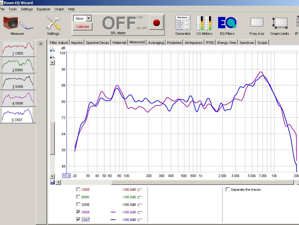

acording to some image i found of internet with freq response on the jamo s606 should't really have any issues either so i think audyssey is setting the speakers to low possibly.
