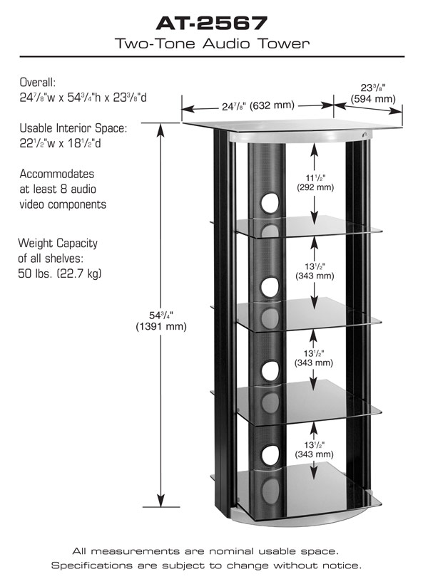

Well I just ordered a new Bello stand that is an open concept which will have plenty of breathing room and is not a closed cabinet. Please see the pic attached with details. The only other equipment around will be the sub that will be next to the a/v stand and above the 905 will be the blue ray player and the Panamax in the middle and so on. I am hearing really good reviews on the receiver and not heard one bad thing about it and doubt that it is poorly made that would cause it to die in the next couple of years so I guess I will take my chances!!! Thx for the input!!!!!

Well I just ordered a new Bello stand that is an open concept which will have plenty of breathing room and is not a closed cabinet. Above the 905 will be the blue ray player
Wouldn't the top be the best place for the 905 as that's where most of the 50+ degree heat can eminate from?
Panjsheri
Well the strongest shelf is always the bottom shelf and I spoke to the Manufacturer and they also said that the bottom would be the best and there is enough breathing room for it to keep cool so there will be no heat issues:D

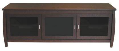

I have my 905 in a credenza style cabinet. I had to brace the center of the cabinet as It was starting to bow in the center with my Sony receiver in it (center - bottom). Even though the cabinet is supposed to be rated for 265lbs. Anyways, I removed the doors and am in the process of replacing the cloth and glass with a honeycomb mesh that will provide airflow through the cabinet so the 905 and PS3 don't overheat.
