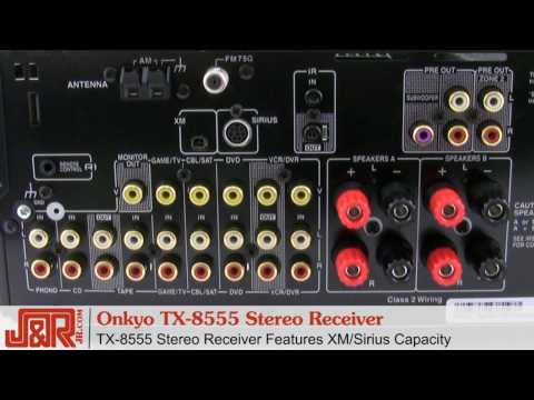

do i need to purchase a crossover because the amp does not have subwoofer output
Seth=L
Seth=L
The TX-8555 does have a subwoofer output. Virtually any subwoofer you look at will have a built in crossover to blend with your main speakers.

I know the Dayton was recommended, however since the onkyo has sub out do I still need a powered sub? Also, do you think it matters what type of wire i use to connect the speakers and the receiver
Seth=L
Seth=L
The subwoofer output is line level, so the subwoofer will need to be powered.
