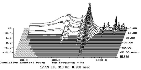

I feel like I might be a broken record here, but the the Infinity speakers can definitely stand some modification. This is indeed the same Peel 'n Seal and mineral wool mod that I have mentioned in other threads. You can see the measurements and comments made by Stereophile here. As you can see in the graph (pictured below), there is a HUGE cabinet resonance in the midrange region, resulting in very audible coloration. Addition of Peel 'N Seal to the interior walls with some mineral wool stuffed in would make a huge difference, though as mentioned before, would reduce the bass extension and output of the speaker somewhat.
