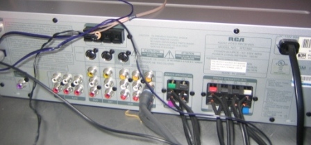

Thanks for all the help so far everyone. I wanted to make sure I understand correctly before i go to the store. If I get a preamp to connect the outputs on the universal player, the preamp outputs are then two channel to connect to my ht receiver? And I then will get the sacd enhanced sound?

My receiver doesn't have the 5.1 jacks and the whole reason i want to listen to sacd is for the surround sound. ;)
SACD has surround sound now? Is that an older receiver?
Cannot see all the connections. You will need a receiver with 5 channel analog in from DVD-A and SACD to make it work. Digital will not pass it.
If you get a new preamp that has the 5 channel inputs, you will still nee 5 channels of amplifications from somewhere.

You can send the stereo analog signal, including that of SACD, to ANY stereo analog input. It does not have to be part of a multichannel input, though of course that means you will not have the ability to listen to the multichannel tracks on any SACDs that have them.
