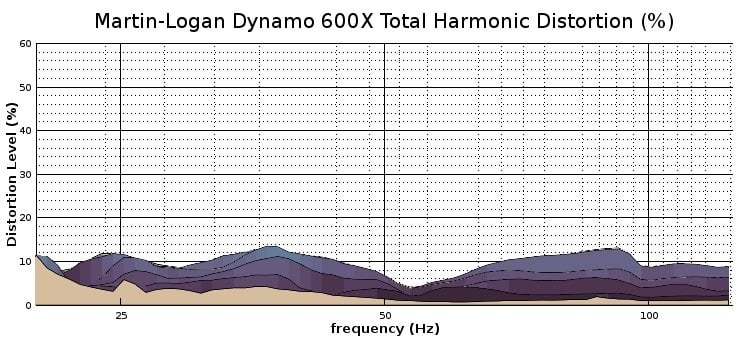

I think the advantages of Rythmik's servo technology only come into play at high excursions where the driver starts to lose linearity. The problem is that is where it is starting to run into the driver's Xmax, and past that nothing can rescue it from nonlinear distortion except less amplification. The vast majority of the life of the driver's excursion will be spent well under these types of limits, especially if your only playing music content. For that use, I think that any of these subs will have similar performance. What will play a far greater role in the sound of the sub is where you place it.
A multiple sub system will do a lot more to improve the sound here than a single sub solution in this regard. If you want a better sound than any one of this subs can give you for the same price consider two less expensive subs that have good fundamental performance. Maybe look at a couple Monolith 10" sealed subs from Monoprice. A couple PB-1000s or VTF-2 mk5s will do a lot to flatten out the response. If space is a concern, consider a couple MartinLogan Dynamo 600x subs, a great sub for its size, and take a look at its maximum THD: it can't really be pushed much past 10%THD at all in any frequency:
