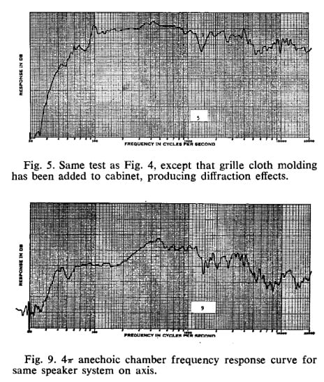

Here are two measurements referenced by an Audioholics article showing AR's research involving the 3a.
Identifying Legitimately High Fidelity Loudspeakers: Power Response & Baffle Step — Reviews and News from Audioholics
The above curves of the famous AR-3a from 1968 clearly show that. In the top figure, the 3a is in a pure 2 Pi environment (“bookshelf,” surrounded by books), and its LF-to-midrange response is smooth and predictable.

Maybe a partial explanation lies in the last sentence of the page linked above:
So all those near-field considerations like driver alignment, cabinet diffraction, phase relationships, etc. are far less important in real world listening conditions than their theoretical importance might suggest.

So a flat frequency response isn't necessarily a good thing subjectively speaking? :confused:
That is a little perplexing because I remember seeing much better FR curves when it was still being sold. Am I correct in saying they were not smoothed if the plots had sharp corners?
I wouldn't make any major conclusions based on these different FR curves, other than they were made by methods that may have had little in common.
  • One was made in 1968 and the other was done in the last 10 years give or take.
  • There almost certainly physical differences in the room and measuring hardware between these two measurements.
  • I am 100% certain that there were software differences.
There were likely other method-based differences too. For example, I assume Dennis Murphy made these FR curves similar to others I have seen him perform – the speaker was mounted vertically on a stand out in the middle of a room with the test microphone about 1 or 2 meters away, mounted on a boom stand. The 1968 AR curves may have been done with the cabinet mounted horizontally. That could account for several large peaks and valleys that Dennis got and AR didn't.
Dennis usually avoids curve smoothing. He would probably say why do the measurement if you want to mask the results.
Some of the large valleys in his "Room Response" curve are due to lower frequency room reflections. It starts at 20 Hz. The "On-Axis Anechoic" curve doesn't go lower than 200 Hz.
The two AR curves clearly show what "baffle step response" looks like. Compared to Figure 5 (the speaker is essentially mounted in-wall), Figure 9 shows the FR curve steps up beginning at about 300 Hz. If you listened to it standing out in the open, the bass below 300 Hz would sound puny and weak in comparison.
I didn't mean to imply Dennis smoothed his curves.
The question I was posing is "Is it correct to believe the curves AR made in '68 had little or no smoothing based on how jagged the lines in this plot are".
On reflection, there probably wasn't much curve smoothing. That would wear out a slide rule pretty quick!:)
And I didn't mean to suggest that Dennis or AR added smoothing to the curves. I know what Dennis usually does. I can't speak for AR in 1968, but considering the absence of computers that can add smoothing with a mouse click, I doubt if they did anything intentional that reduced their resolution. In those days, curve smoothing was done by switching to a dull pencil.
:D LOL :D
AR's FR curves actually look rather good. I wondered just how they could have done that without computers and their built-in iterative calculations and Fourier transforms. Did they run a continuous sweep of frequencies and record the sound without any data processing? I wonder how long it took to generate one good FR curve?
I know that Dennis's PC generates a series of white noise pulses that get converted to analog and are sent out to the speaker. The microphone picks up the sound, the computer digitizes it, and processes it to the FR curve we see. It all happens nearly instantaneously, and no slide rules are harmed in the process.
