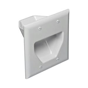

Is there any reason why I should spend the money (~$50) to get something like

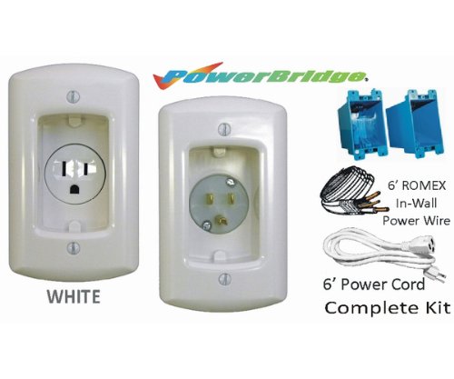

this (shown below) versus just running the power cords through the wall? I've read that this might be an issue with insurance because of fire codes, so I'll check into that, but I'm wondering if this actually represents a real risk. To me, it seems perfectly safe to run the power cables through an open cavity between two sheets of drywall. There's no insulation in there, and I could place them inside of conduit. Honestly, I think that it's safer for me versus connecting up and running the Romex. I wanted to ask before doing something stupid, though. I'd be using wall plates, something like what's shown below at the bottom, so it wouldn't be permanent.
