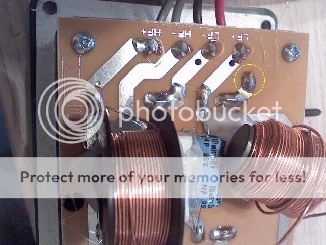

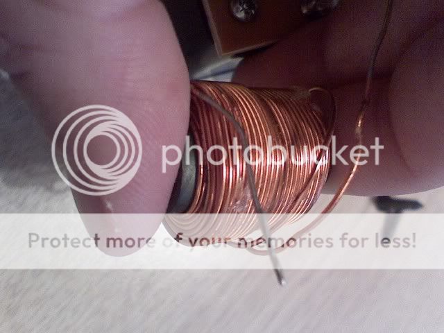

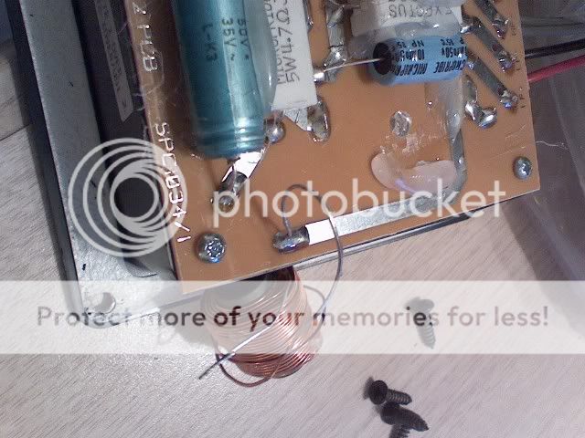

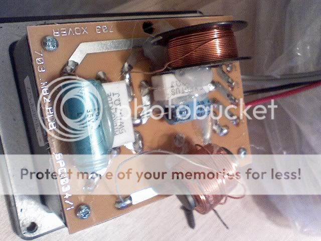

ok where does this go, loose piece on xover
N
njsporto
Have 2 mission 772 speakers. Ups dropped them a while ago, got an HD so I want to use now. I assume these shouldnt be loose :)
i248.photobucket.com/albums/gg189/njsporto/1009081825.jpg[/url]
i248.photobucket.com/albums/gg189/njsporto/1009081825a.jpg[/url]
i248.photobucket.com/albums/gg189/njsporto/1009081826.jpg[/url]
i248.photobucket.com/albums/gg189/njsporto/1009081826a.jpg[/url]
1) Any good speaker repair places in NJ?
2) If not, where is this soldered to? HF+?
3) what is a good way to resecure the piece onto the board?
4) Does the copper wire need to be wrapped tight against the piece?
4) DO I need to completely replace it?
Any help you can give would be great,
Thanks Greg

Just a guess from looking at the photos.
Try touching the unattached wire from the loose coil to the solder blob where I drew the red arrow. See if that makes the speaker sound normal.

It's hard to tell from the pictures. If I were in your position I would first, clean off the extra glue from where the inductor was glued. Then I would try to rewind the inductor as tightly as possible (similar to the other unit) then in the last picture mazer has up you there is a blob that has nothing soldered to it thats the one...Make sure this works by running the speaker with it like this. Re-glue with a hot glue gun and you are good to go.
I can't guarantee this will work, but it seems like the point where contact was lost based on your pictures.

Looking at the pics I'm certain it broke loose from the same place indicated by the red arrow and yellow circle in the pics posted above.
Not sure if attaching it back will hurt the speaker if it has power??
It won't hurt the speaker as voltage at the speaker is not enough to really hurt anything - but it's just a good general rule of thumb not to solder on active components - so disconnect it first and follow the very nice how-to posted by Ryan above.

You'll be able to tell quite easily where it goes without poking around with it connected to the amplifier. I would not reccomend trying it that way. It looks like it went right where everyone has been saying. Worst case, Just open up your other speaker and look where it went ;)
If you dont want to do that just melt the solder where we've highligted, there will most likely peice a small peice of the wire there.
