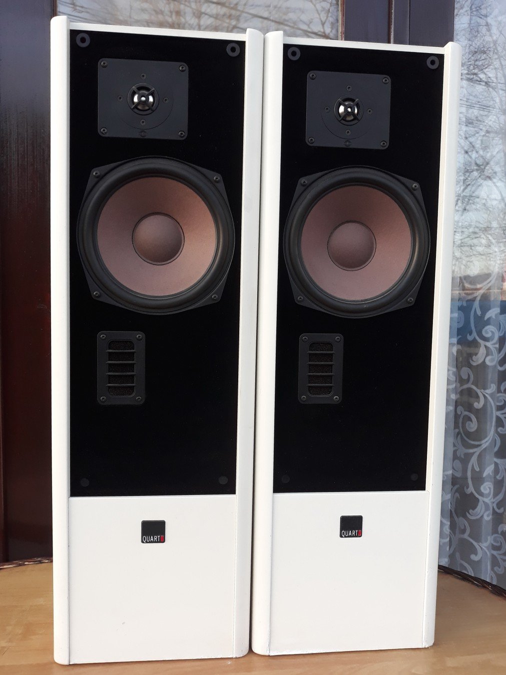

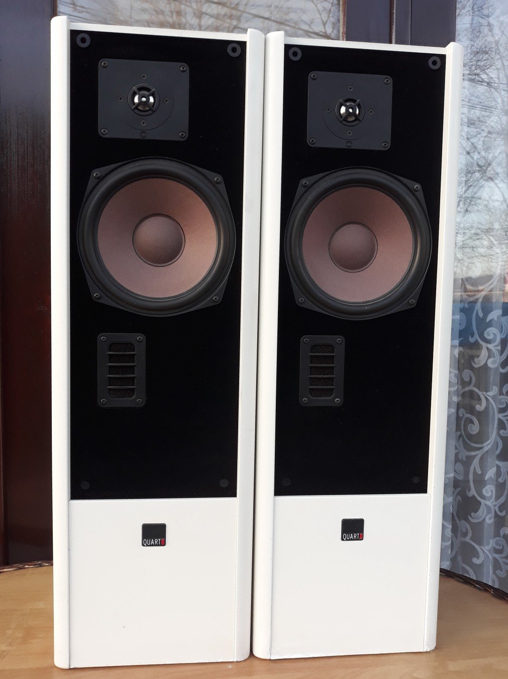

I can recommend any of the late 80's and early 90's era MB Quart's !
I have a pair of these that I've replaced the woofers in with Hi-Vi's and a recap. I love love love them !
Still my favorite line of speakers....ever.
In 1988 (when these MB Quart 350S's were made), the store I worked at was offered this line to sell.
We declined to pick the line up due to the high cost...these were around a thousand a pair retail.
We just didn't think we could move them.
I took a pair home to demo for a few weeks and was blown away.
Notice how modern they look, most speakers made today don't look this sweet ... way ahead of their time.
Heavy as hell, with top notch drivers and top of the line crossover parts.
Found a pair of these 350S's and a pair of 280S's on EBay 14 years ago for next to nothing...seller didnt know what he had !
Unfortunately, they got bought out later and put out some lines that were not so good...before they got out of home speakers all together.
